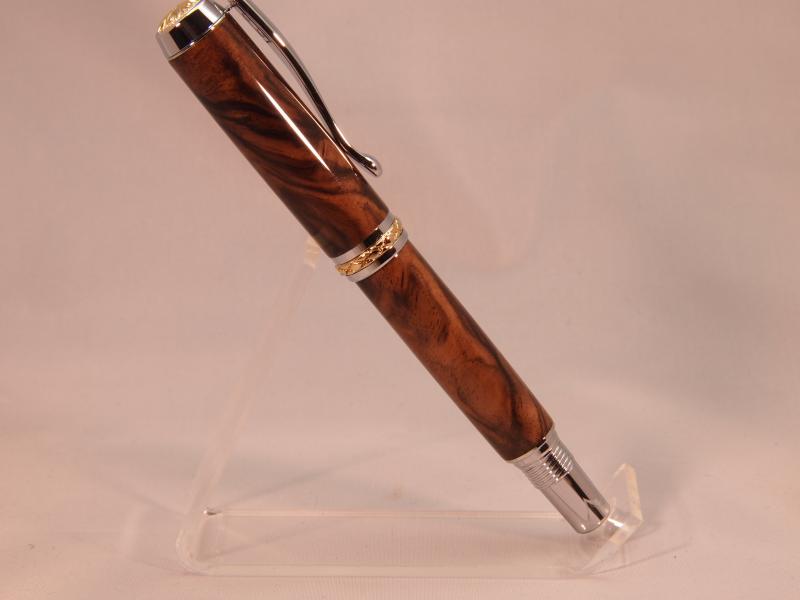

It's moisture most likely, as said above.
I used to have the same issue.
Here's my method.
Wipe the blank down with DNA.
I put 8 to 10 coats of thin, I use accerlerator after the 4th or 5th coat
then 8 to 10 coats of Medium, use accelerator same as above.
I stop the lathe and look at the finish after the first 4 or so if I don't have a shine, I know something is wrong and i fix it.
Then I let the CA cure a minimum of 24 hours, then wet sand, and mm, and polish with tripoli.
Here is one I did last night, I get this type of finish on all my blanks, even Cocobolo, which some say you can't do CA on.
Hope this helps.
Additonial note, I also seal the ends with CA right after I square the ends up (before I turn), that way there is no way for water to get soaked into the exposed end grain while wet sanding.
