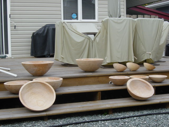

I did these ones last June and are turned to 1 1/8" to 1 1/4" then end checked the end grain and are now down to less than 6%. After finishing them I leave the foot on and take it in the house for a few days in the warmer room temps then finish the foot off.
Lin.

How did you let them dry..soap..brown bag..air dry..??
