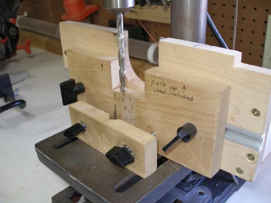

I made this home made jig. A little while ago I drilled a 3/4" blank with a 17/23 bit and nailed it in the center. Remember, the table on the drill press being "flat" and "true" is the most important thing for repeatability. Here is a picture of the jig. It's a copy of the one Woodcraft sells. Good luck.
