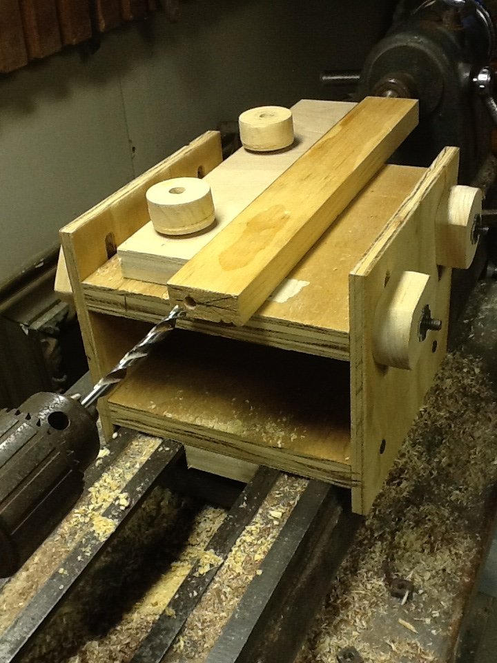

my lather drilling solution
I have an older lathe - 1950's - and the tail stock does not run smooth enough to invest in a Nova or simiar setup. My solution reverse the action.
A simple adjustable jig and my jacobs chuck. It may not be elegant, but it is functional. Drilling round blanks take a bit more care.
Hope it is of help to someone.
