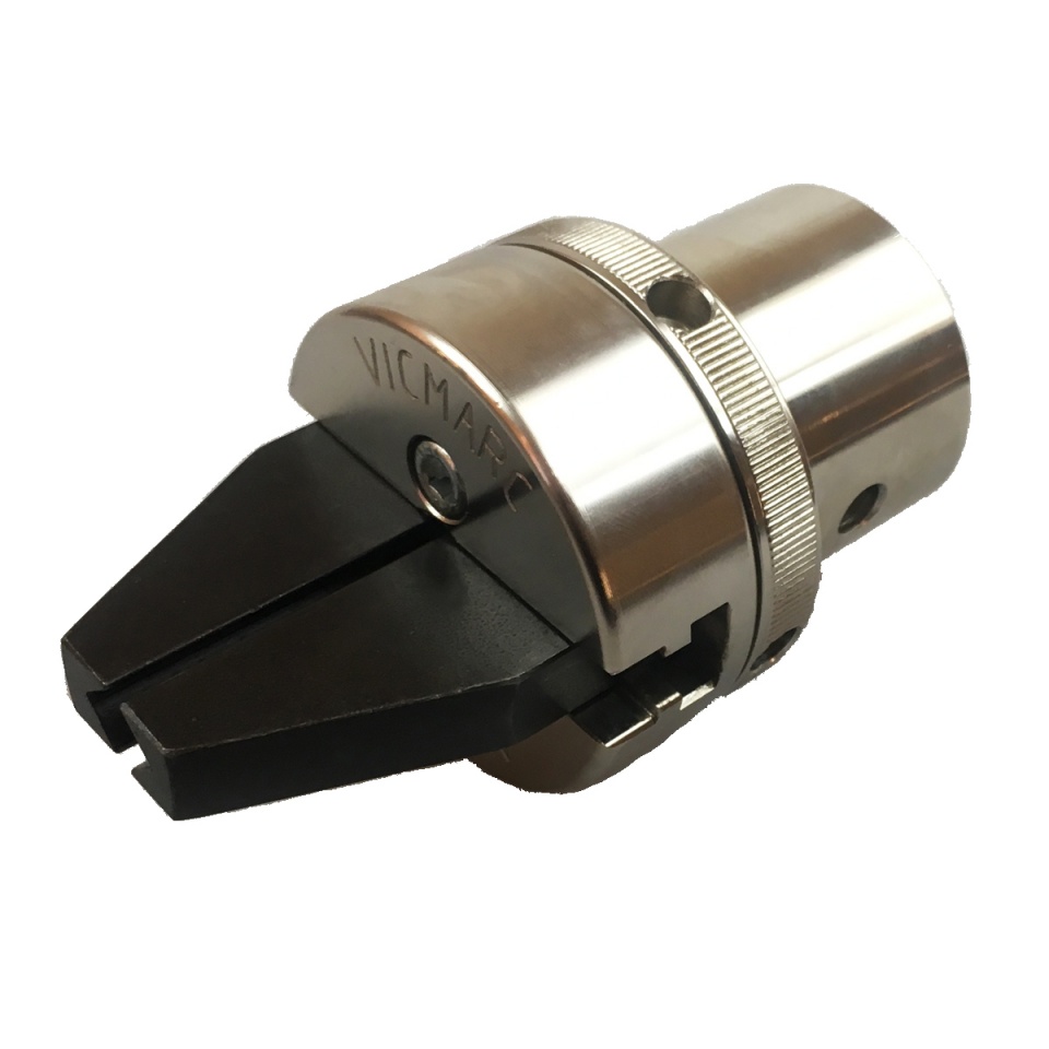

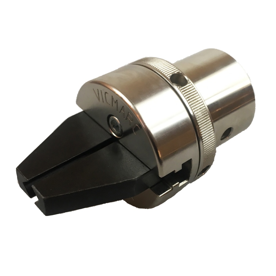

Nanigai
Dec 1, 2016
15
Townsville, Australia 4814
Old thread
Richard this thread is a bit old and Im sure the OP has sorted his problem by now. Just thought I might add my .02c for anyone else looking for ideas.
Not sure who sells Vicmarc over there but I believe its available from at least one outlet. Since switching to this chuck my failures have dropped to zero.
Here is the link if anyone is interested.
Cheers, Ian
