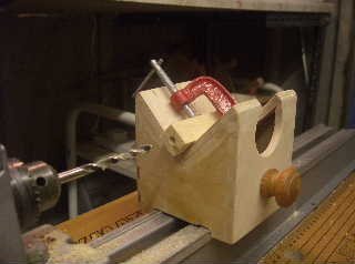

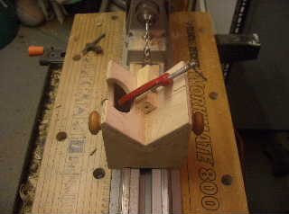

<br />Hi All,
I have found a solution of sorts!
I managed to put together a bit of a homemade clamp for holding the blanks on the lathe, and taking them to the drill bit in the chuck.
It works very well, and I can get an accurate hole through a blank without the doubt or worry of trying to do it free hand.
It is a short term solution, but I am pretty pleased with myself for the design and development of this little piece of kit!
Please see attached some photo's.

Kenny that is a very good idea and a nice job of carrying it out. Just have all blanks the same size and you will have it made.
Bob
