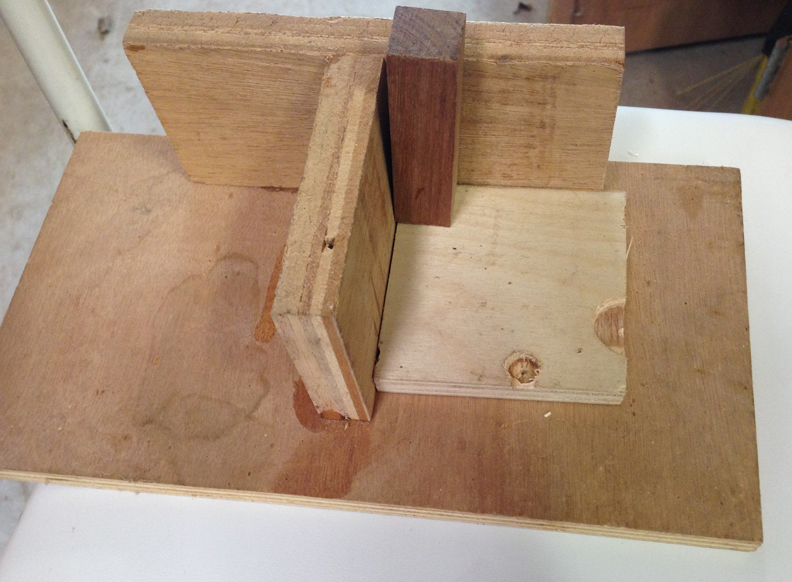

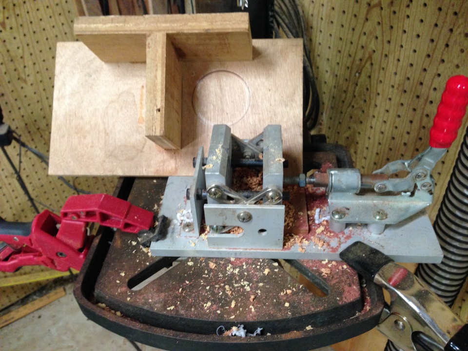

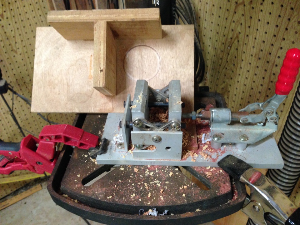

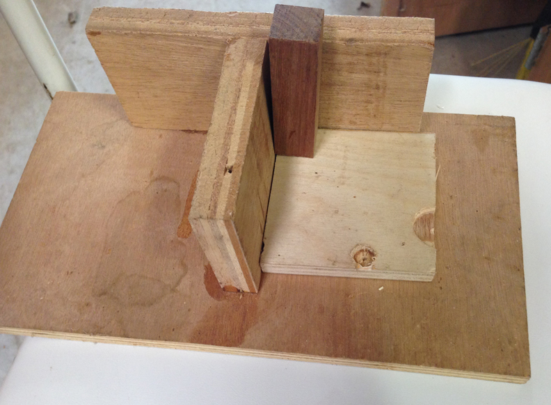

I do all my drilling on a drill press. I have no problem drilling straight, centered holes when I take my time to make sure that the table is properly aligned & that I'm starting in the center of the blank. In most cases, that degree of precision isn't necessary, but when it is, it can be achieved on a DP as others have noted.
I now use a pen vise to drill pen blanks, but when I first started, I built this simple & dirt cheap jig to hold my blanks. I still use it for stoppers and other larger blanks.
Also as noted previously, it is important to clamp both the vise or jig to the table as well as blank itself. When I use the jig, I put clamps on the two exposed sides of the blank and clamp the jig to the table.
Whether you use a lathe or drill press, make sure the bit is sharp, drill at the slowest speed possible, advance slowly & clear often. When drilling acrylic, I only drill about 1/8" to 1/4" at a time, then I turn off the DP after every 1/2"-3/4" for a couple of minutes to let the bit & blank cool down. Others use a light water spray other other means to keep things cool. I just go work on something else for a few minutes.
There's lots of ways to approach drilling blanks - this is what I've settled on, but you should experiment with different techniques & see what works best for you.
