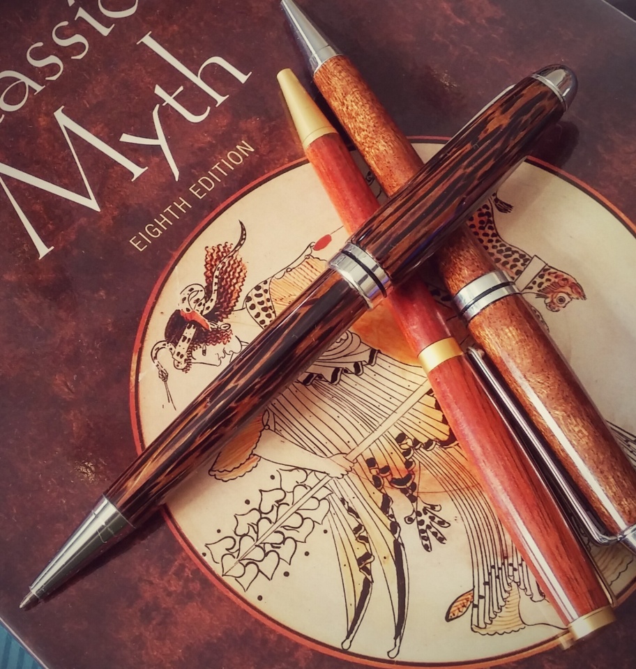

Also this was a bit of a panic, getting discouraged post, I needed to make a gift pen for my son with a deadline and after a half dozen or successes things started to go south.
Since then I have regrouped and kind of back on track I drilled a set of blanks last night with my improved homemade improved blank drilling jig and I was pretty spot on. I'm only about 2 or 3 mm off center at the other side of the blank.
Well off to my new adventure of turning something new, Black Palm, which I'm not even sure its wood. I've read the precautions mostly to hit it with CA before final sanding.
Wish me luck. :)

"Well off to my new adventure of turning something new, Black Palm, which I'm not even sure its wood. I've read the precautions mostly to hit it with CA before final sanding. "
Be prepared to have a steep learning climb with turning palm. Allow yourself some failures with it as you learn.
I like it, but it is more like turning as handfull of porcupine quills. Patience, thin CA glue, and sharp tools with shearing cuts working down hill give me best success. I like the outcome so I keep turning it.
Good place to have scary sharp skew and a light touch. Flat top carbide tools likely will not be your most successful choice.
wyone
Jul 16, 2014
1,764
15314 Grasslands, Parker, CO 80134
Black palm is NOT something to try when you are having a bad time.. At least not for me. I have had WAY more failures on black palm than any other wood. A lot is ME I know, but still.. I think one of the most difficult I have turned.
chartle
Mar 13, 2015
1,287
Pgh, PA
:mad::mad::mad::mad::mad::mad::mad: Tell me about it
I would have rather shaved a ferret. :cat:
