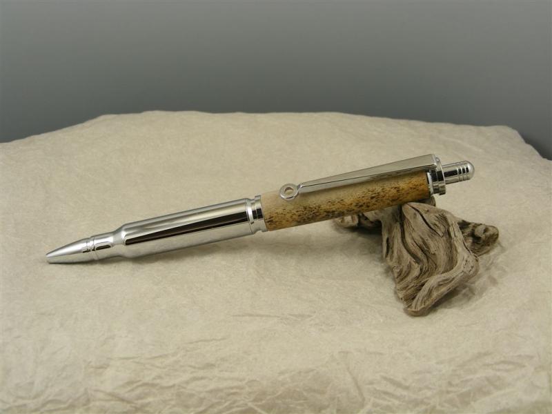

Over the last few years I have drilled antler many different ways, some not so safe. This is how I do it now, a safe and easy way. Watch the video on you tube
http://www.youtube.com/watch?v=SAEEaF8z2jM

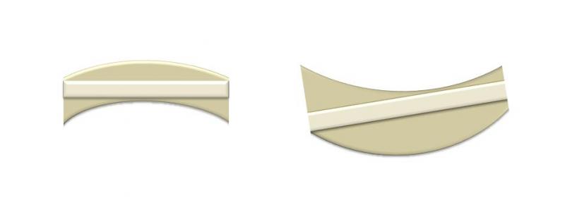

It works! I tried it last night and it worked great. Shapes like these are what I've been having trouble with. I could turn them round and put them in a collet or Nova chuck to drill on the lathe, but I would either lose the bark or there would not be enough round area to grip with the chuck. Clamping them in a drill press vise with lots of shims works, but it is partly guess work, and sometimes I guess wrong. This is a clean, simple and brilliant solution, thanks.
