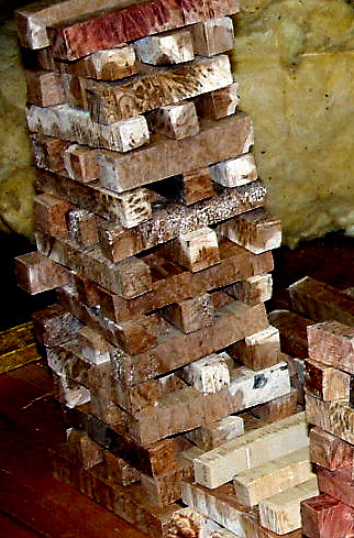

An old pic of some of our tough burl timbers drying in my roof some of five hundred at that time, typical of the timbers I drill routinely. the day you set out to get your drills sharpened for you would seem unneccessary to me.
