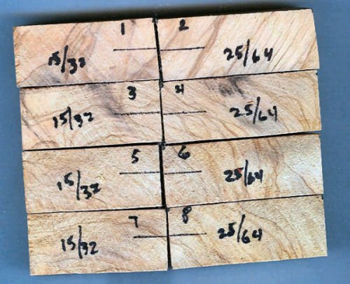

I reversed the 15/32 and the 25/64 drill bit holes in an expensive blank for the Baron. Suggestons on how to salvage? What about cutting down a dowel and gluing it in the existing holes snd redrilling? Ant help is appreciated.

You can probably chuch up a piece of 1/2" dowel and sand it down 1/32 to fit the 15/32-drilled tube. I'd use epoxy or poly glue to glue it in and give it overnight to set up since you are going to re-drill it. If you take your time on the blank-half you drilled at 25/64, you should be able to center the 15/32" bit and ream it out to 15/32. BTW, that's one reason why I mark my blanks with cut lines, grain alignment lines and drill bit sizes. The numbers are used when I am cutting more than one piece of the same specie of wood.

I would approach this from a different direction. First off if you put a dowel or a dowel shaped piece in the hole then try and drill it out it won't work. You are drilling into end grain and two different kinds of wood. It will not drill straight, the drill will run out and ruin your blank. You only have a wall thickness of .039" to play with.
Think about this way. Get another piece of wood, an inexpensive pen blank of some easy to turn wood. Drill the proper size hole in it. Cut it the same length as the problem blank. Install the brass tube in it, by that I mean glue it in as if it was going to be a pen. Turn that blank down to the diameter that will allow you to slide it into the problem blank. Now you have the bushing made with the brass tube centered in it. Glue it in the problem blank. Trim the ends. Make a pen.
You will have to have a good glue job on the bushing that you are making. When you get down close to the brass tube you are only going to have that same .039" wall thickness, or actually to leave room for gluing in the blank you are fixing about .034" wall thickness of wood left.

Cat, I think you are going to have to write that blank off.. the bottom barrel of the Baron is about 15/32 give or take a couple of thousands... so if you have already drilled what should be the bottom blank with the 15/32 drill you will have nothing there even it you perfectly dowel and drill it and then turn it to the right diameter...
The walls of the Baron are about 3/64, there ain't a whole lot of meat to play with...

Let me get this right? Your top blank is too long and your bottom blank is too short if you go by the size holes drilled. Why not add some accent wood onto the too short blank and cut the too long one down? At least you still can use the wood and it may turn out better then you expected. If you ended up not swaping the blanks as you indicated and have two with the same larger hole size I guess there is not much you can do.

How much material is left on the blank with the larger diameter hole after drilling? Can you cut in half down the middle and glue it back together with the hole remnants facing out? The grain won't match, but depending on how much wood you have left, it may give you enough to go with. Alternatively, do this for both halves and make a slimline out of it!
Still another idea is to cut it into quarters and re-glue it after sanding down each of the cut ends a touch. Again, you'll have repair marks and the grain won't line up, but that may be better than tossing the blank.

Given that the numbers were a little different.....i.e. you were making a big pen where there was a little more wood involved..... Mac's solution is clearly the best way to go. Gluing in a dowel and re-drilling would a require degree of precision that most of us just can't muster(Bruce Boone excepted).
Using the figures that Griz offered, I made a quick sketch on my CAD program and discovered that after bushing the hole like Mac suggested, turning the blank to the wall thickness quoted by Griz, the actual thickness of the outer wood shell would be about 0.008".....that is the thickness of 2 pieces of laser printer paper. Someone with a small machinists lathe might be able to do that; but I doubt most of us could do it on our JET mini??? I can think of several things you might try; but all would be more trouble than they were worth. If it were my project, I would either take a shot at a segmented pen or just blow it off as a learning experience and start another pen.

There is really no reason to just throw the blanks away, after all thats why the oops band was invented. First cut the blank that you drilled 15/32 and cut some off and glue the tube into it. Then take the 25/64" and also glue it up, when it dries make a clean square part and drioll a small piece of wood that would look good and glue it to the bare tube. Now if you want to make the top to match the bottom that now has the oops band on it part off a little wood and glue some of the same wood that you used for the oops band. If you look at the photo albums you will see many examples of oops band turnery.
