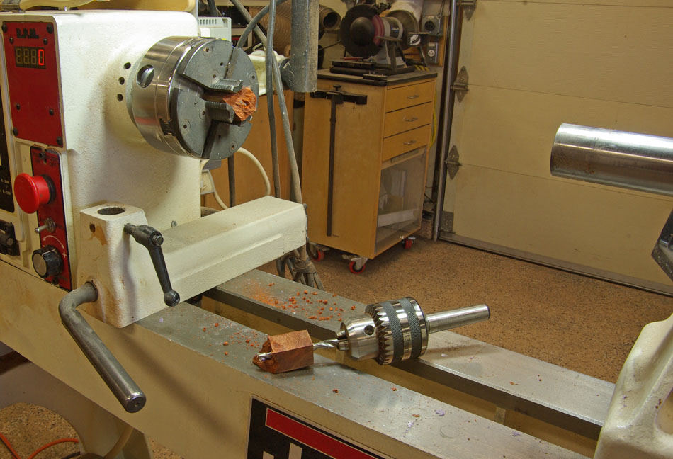

I can tell you how NOT to do it.........My bit got stuck while I was pulling the tailstock back after drilling. The lathe was spinning at 500 rpm, the chuck taper popped loose, and I had the whole mess spinning. The chuck started whipping all over and the bit snapped. All of this before I could hit the stop button. I won't try that again. Lost one beautiful piece of amboyna burl and a very nice drill.
