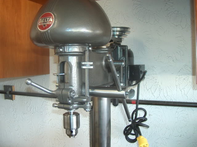

I've got one like this except it's got some surface rust and lots of sawdust on it:
4" quill travel. I can drill down the middle of a 3/8" square blank if I don't rush the setup.
If you can drill successfully on the lathe, that's great. If you can drill successfully on the DP, that's great.
