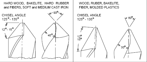

Below is a pict of drill speed results done by an on-line engineer friend of mine on another forum. It is clear to see that the overall speed increase makes for smoother cuts. That test was done in soft pine which will exaggerate the problem of roughness. But it is clear to see that slower speed (or dull bits) will have more a tendency to "tear" the wood, catch and cause blow outs.
The original link is from BT3Central and was posted by LChien; The pict above is posted with permission from him. To see the original link Click here!.
