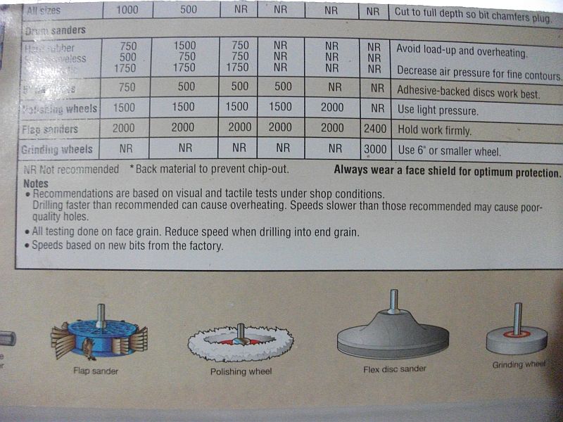

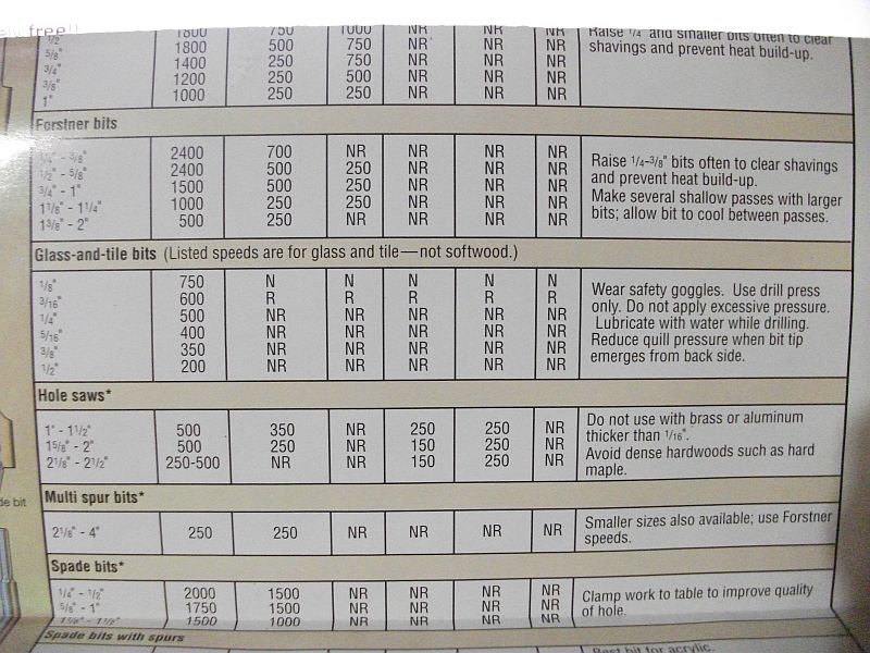

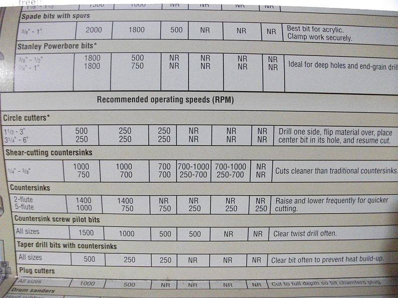

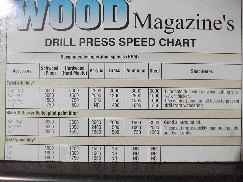

Here"s some pics of WOOD magazines drill press speed chart.Don't know if you'll find it helpful of if others would agree but I'll share it anyway.

don't agree:biggrin:
One thing you have to remember it is a pen blank you are drilling and drill into end grain so to me those charts are useless for what we do. My opinion only.
