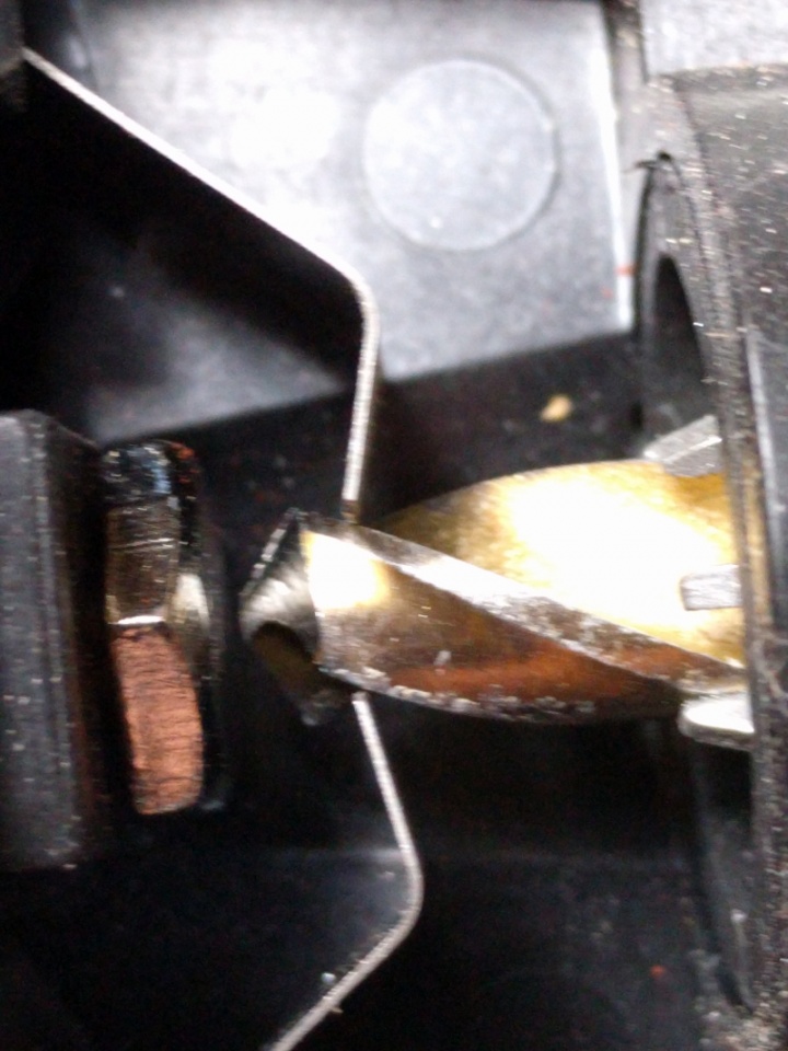

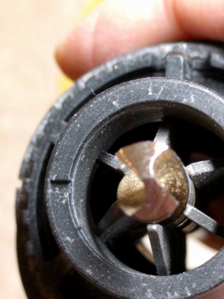

This is how I set the bit and the results.

Definite that we match on picture 1. But my results are not the same. My chisel is slanted backwards/before 12 pm when looked at like a clock, compared to yours.

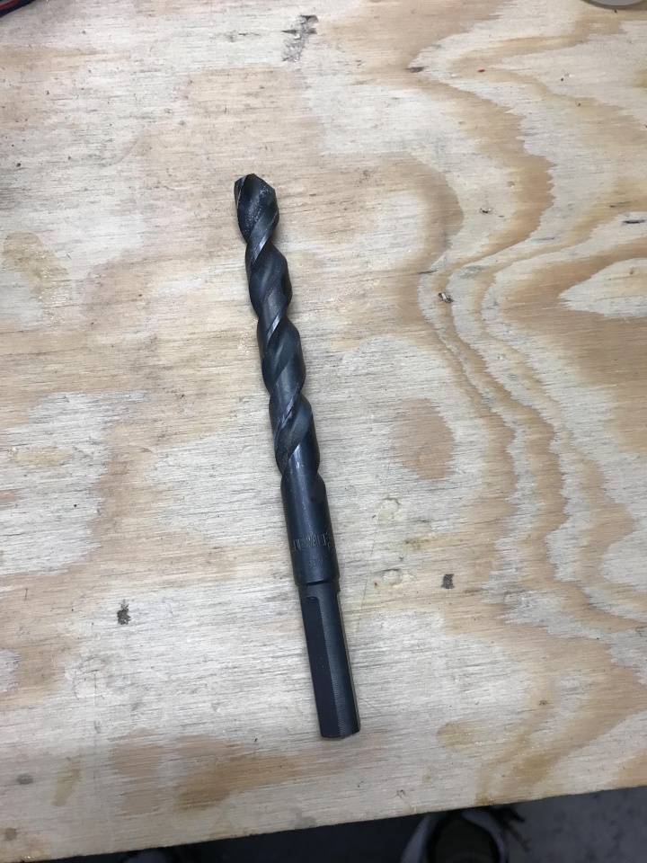

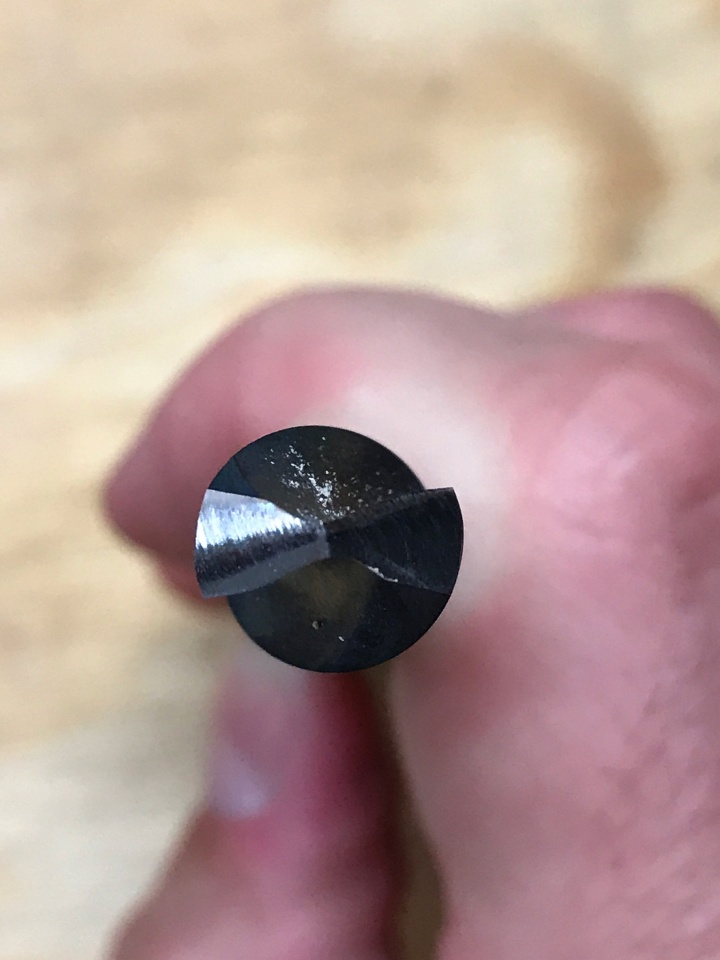

Here are pictures of the most recent bit I ruined. I emailed Darex this morning and Taffy responded. She hasn't seen pictures yet but thinks my older version of the drill doctor isn't set up to handle the type of bit I'm using. They have an upgrade program I may take advantage of.

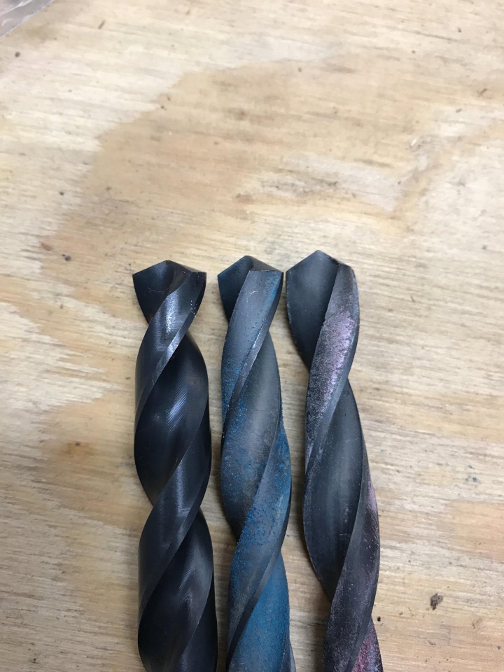

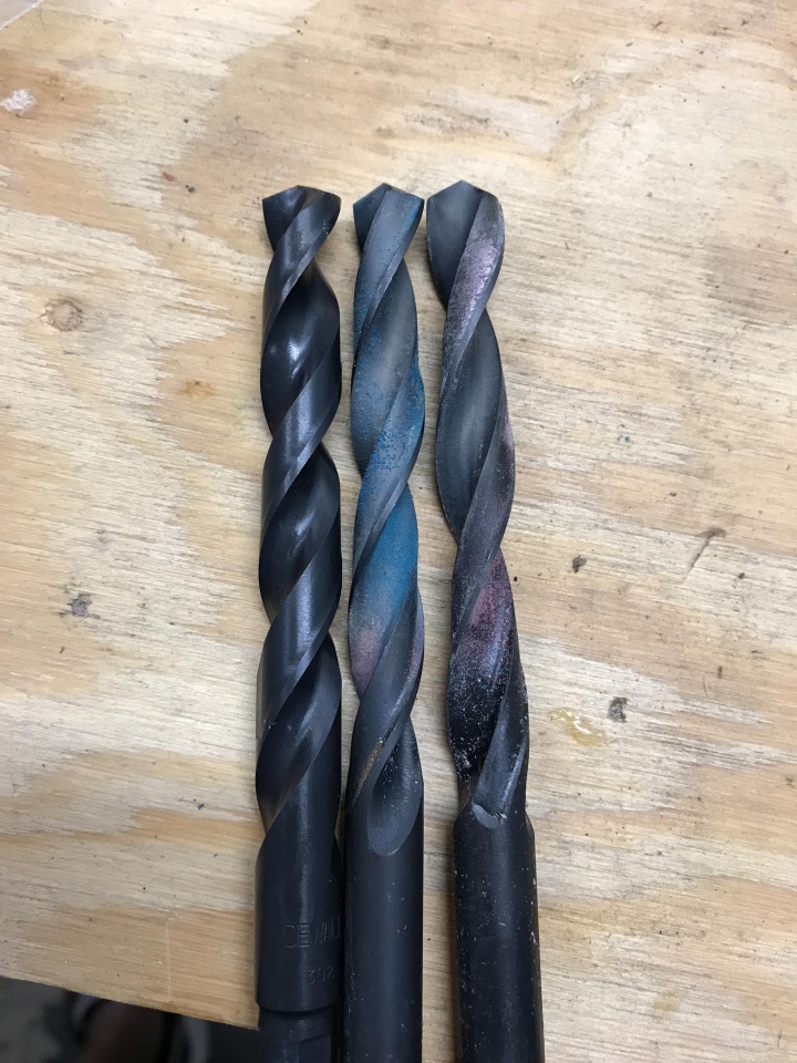

OK, sorry for the delayed response but I've figured out the issue. With the help of my own brain/eyes and further emails with Darex. As it turns out, the bits I'm getting from Lowe's are 135 degree bits. The Handyman 250 Drill Dr. version I have cannot sharpen 135 bits, only 118. That's why the very first one I tried worked. Not only are they not the same degree, but the Lowe's bits are a tighter twist pattern. Again, not something the older Handyman 250 can handle.
Looks like my attempt at saving a buck backfired this time. We'll see if I can sell in on Craigslist or something to make a few bucks back.
Cool thing is Darex offers an upgrade program so if I wanted to get the 500x model, it would cost me $59.99.
Either way, thanks for all the help and suggestions! Turned out that none of them would've helped in this situation but I'm sure I'll be referring back here in the future. I attached some pics in case it helps anyone else.
