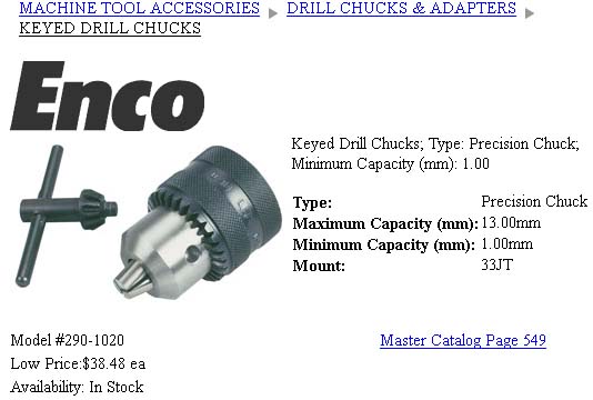

Anyone know if this drill chick is a good one?
I cannot tell from the picture what the brand is. I may need to call them tomorrow and ask.
