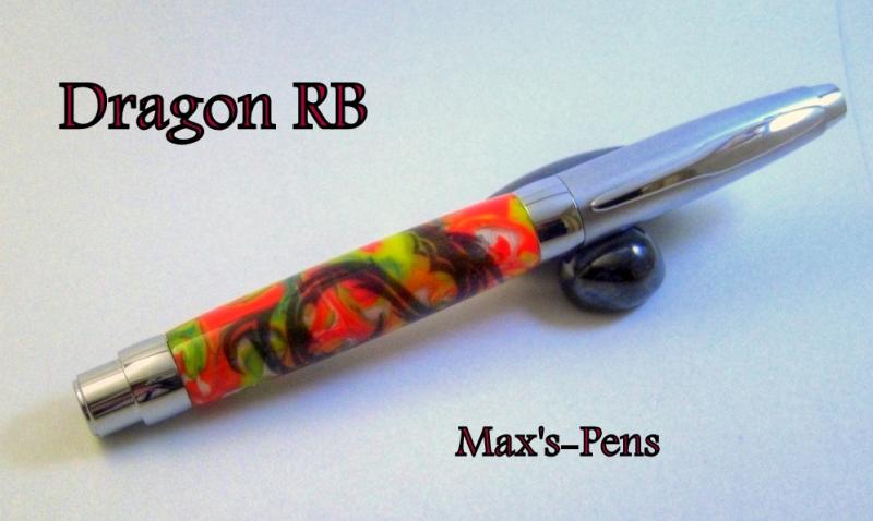

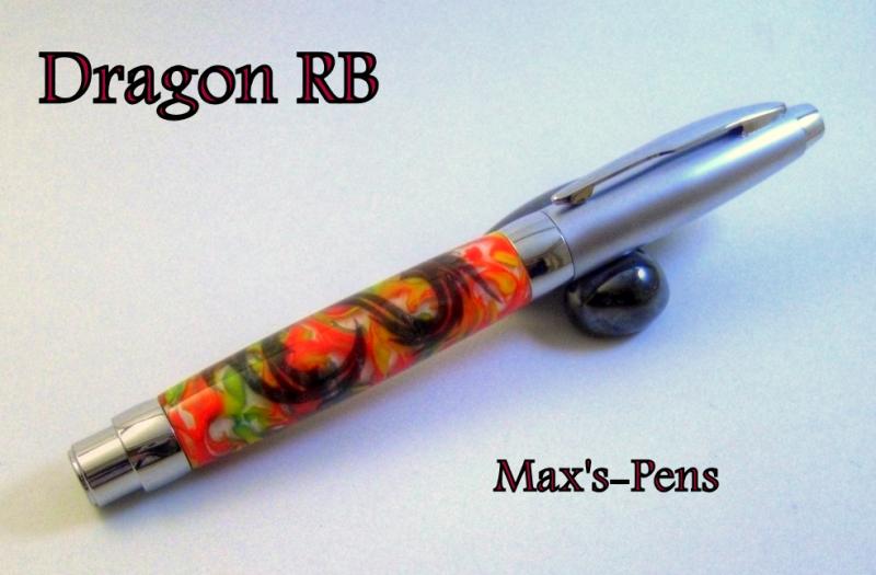

This is one of PSI's Presimo Pen Kits, The blank was cast by John (desertrat) The Dragon is a temporary Tattoo, it has a CA finish that was wet sanded to 4K then plastix polished. Comments welcome Thanks for looking. :biggrin:

that looks like a nice kit, but you should show a picture with the cap off of it also! very nicely executed!

Thats sooo sweet Max.
Is the temp Tatoo a slide or a lick n stick? How'ed you do that?
Lupe it is a water transfer tattoo, I turn the blank down to the size I want and sand to 400. I wipe the blank down good to make sure it is clean then position the tattoo where I want it and apply a wet paper towel. Once the water soaks the paper backing the tattoo will adhere to the blank, remove the paper backing and gently pat it dry with another towel. I apply 5 coats of thin CA and 5 of medium, let it dry, wet sand, MM and polish. :biggrin:
