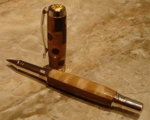

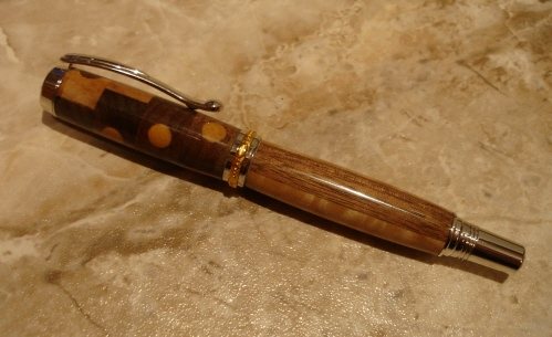

Jr Statesman II , Maple and walnut with maple and walnut dowels. The writing barrel is 4 laminated strips alternating. Finish is System 3 Mirror Coat.
