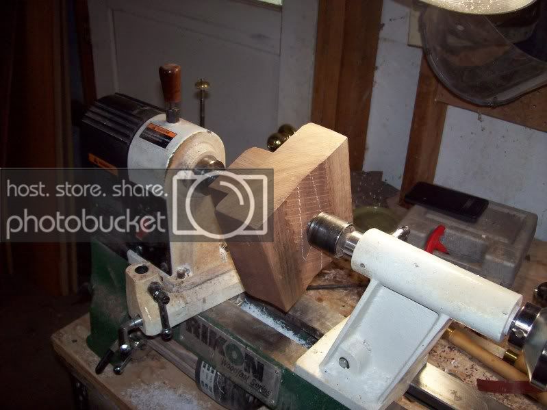

How do you orient the grain on the waste block? Do you mount it cross grain or end grain? In that photo it looks like end grain.

For the strongest glue joint you want long to long grain contact with the blank. An endgrain glue joint would most like fail at the first bit of resistance.
