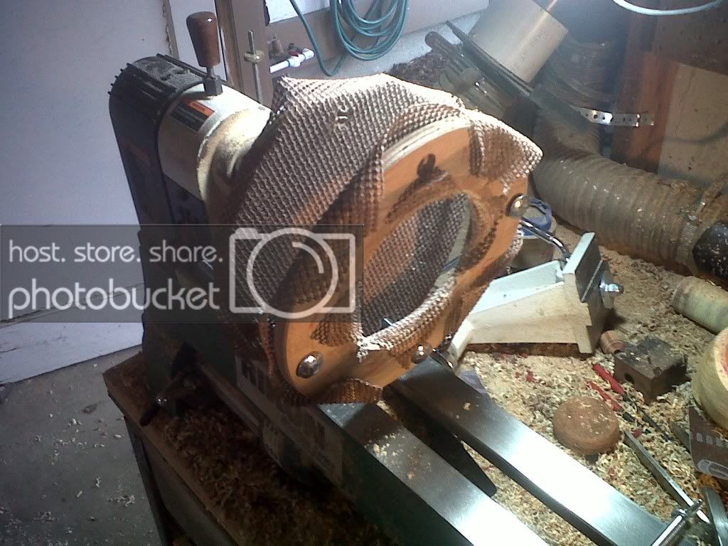

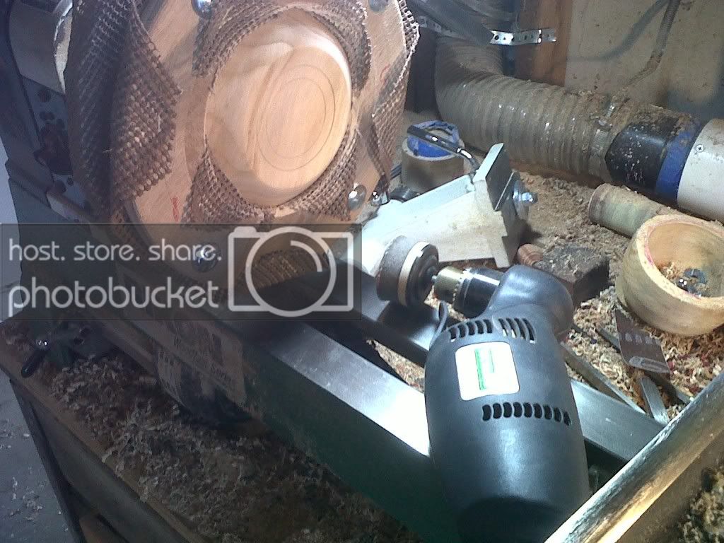

Meet my new best friend:

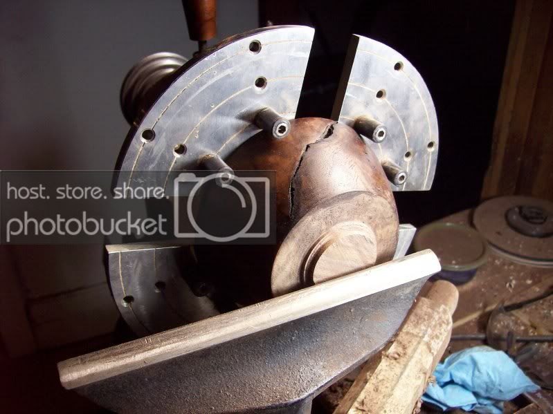

What a vast improvement over this rather dodgy exercise for finishing the bottom of bowls:
Add this to the, "Why didn't I do this forever ago" list!
Mine was based off this one http://www.nealaddy.org/node/8
I just added more padding (drawer liner)

Where were you when I needed this a week ago. :mad:
Thanks for posting and with a great idea. :good:
My next jig to build. :smile-big:

Thanks for the link!
His jig is much prettier than mine and I really like the idea of the threaded inserts over the wing nuts. The only thing I don't like is lack of padding on the rim side and the number of bolts. (4 is figity enough) I think my next one will definitely incorporate the threaded inserts!
