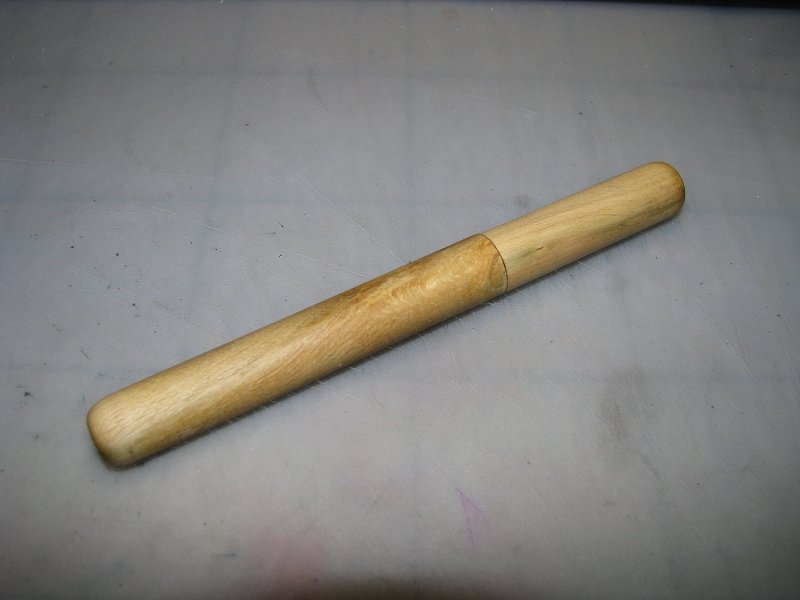

Rethinking even further, just bore a barrel to 0.485" and 3-7/16" deep and the standard Sharpie just fits in there nice and snug. When it's dead, grab the black part with pliers and twist it out again.
Chthulhu
Oct 15, 2010
233
Escondido, California
For the cap, bore to 0.505" and 2" deep, cut off the clip and the little nub under it, and shove that in.
Here's a quick and dirty, drilled from the wrong end of the barrel so the grain doesn't line up with the cap, and I cracked the barrel at the lip through a knot, but it works! <G>
"Sanded" with ScotchBrite and "finished" with a mineral oil rub.
