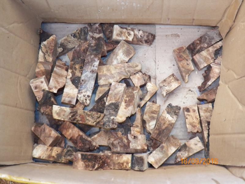

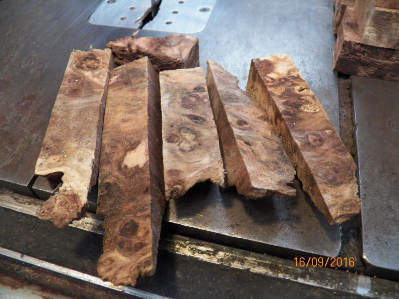

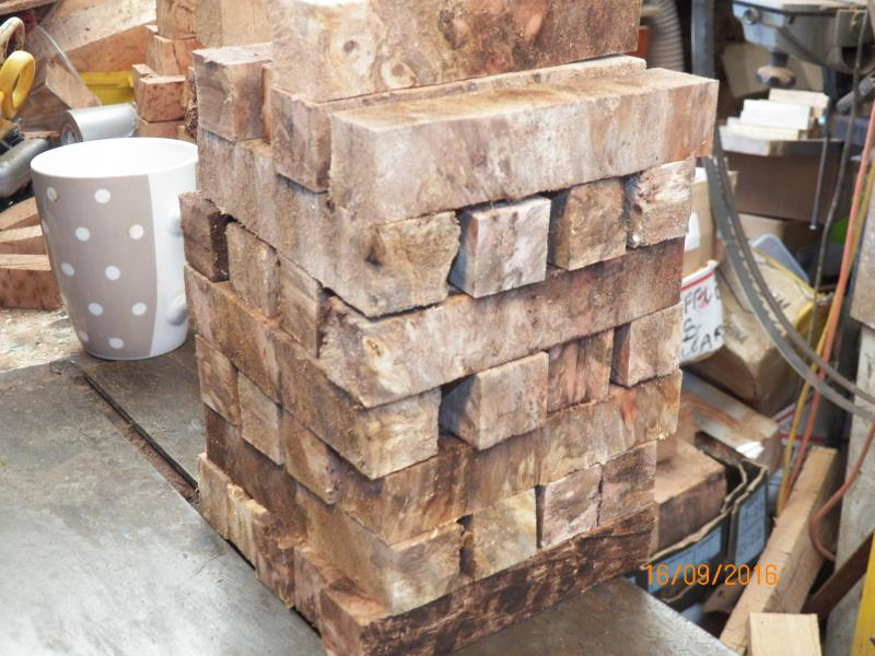

I never took any pics of the piece (about 16" diameter x about 5" deep), as soon as we got home that day, I took it to the bandsaw and sliced it all up in 1" slices, after I blew all the wet soil out of it.
I could tell that was water logged and old, it looked from Black Poplar but, it can't be, the meaty part is very different, no holes and absolutely stunning colours. I'm not sure if they will require stabilization but I won't mind if they do after dry.
I have also managed to get a few good pieces for casting, they will be dried in the oven soon but the blanks, I will let them dry naturally to prevent to endup with split bananas, with the Summer not being far, they will be dry fairly fast...!
So, what am I so excited...?? well, I don't know yet what burl is but, doesn't matter, I will make so unique Resifills out of it and the full-size blanks, apart from keeping a couple for my private collection, the rest will be shared/sold to my IAP friends, I will not list them, they are only for IAP members...!
What price..??? don't know yet, I will wait until they dry and see what I will endup with, I know, they will be pretty yummy...!:wink::biggrin:
I took some pics today so, here it goes...!

Well they sure look like they'll make some great pens. great find.
Thanks mate...!
I was sanding these blanks last night for some waxing today after I decided to put them in the oven with other blanks I needed dry however, I took these out after 18 hours or so at about 50°celsius hoping they wouldn't transform into bananas, even then I had 3 that I had to cut as shorts they curled far too much.
The idea was to get as much water from the wood as I could, I have an order request for some of these blanks and I didn't wanted to make the order too heavy.
I was starting to believe this burl was from a Tortuosa Willow burl tree but, after got it out of the oven, I could tell that I was wrong, it has small areas with burl eyes like the Peppercorn burl but the rest is very different and that puzzles me.
Some blanks seem to have lost more water than others, they are not yet as dry as I wanted but, they are OK to be posted and dry after arriving at their destination, that acclimatizing is always recommended, anyway.

Don't worry mate, I was just this afternoon sorting those blanks after they spent 18 in the oven just to drop down the amount of water they had, they are still not dry and I;m not going to wait until they finish drying here, they are going to be sold here on IAP to my "fans" and let you guys take care of them.
When I got them out of the oven 2 of the full size blanks were looking like bananas so, I have to cut them shorter just to save something out of them but since out of the oven(a few days ago) I have sanded them to correct sizes and give them a light coat of wax of one face only (for the pics) one of the blanks I got out of the oven had a little bend but nothing to worry about, it was still OK when I sanded it on the drum sander but this afternoon while sorting them, that blanks way worse than a banana, you can see the straight sanding marks from the 36 grit sandpaper but the wood ain't far from making a 90° angle, amazing there are however stunning blanks, for sure...!
I see they want to curl so, I had to strap them all together tight until I make those packs, I can then tape those ones with at least another 3 burl blanks to maker a 4 pack, they won't curl that way...!
