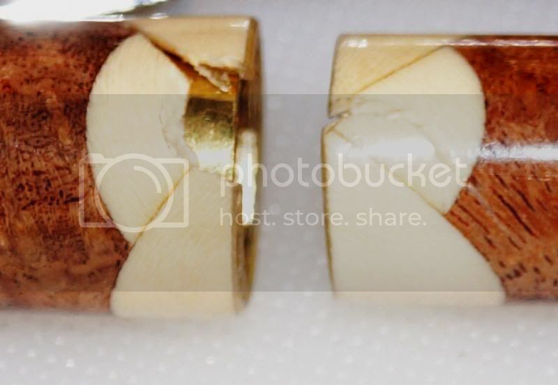

Today I was happily making my first feather pen using Majestic components. I got the blanks turned and polished without incident. They turn very nicely! Anyway, I went to assemble the lower barrel, and I noticed the finial was tight - normally you can slide the components inside the tube ~1/32" before you need to press them in with something other than your fingers. This one barely went in at all. But I started pressing it in anyway and it cracked the blank!:mad:
I knocked the finial out of the blank, and checked the diameter of the press fit part. Then I measured the tube in the blank (at the other end), and I also measured the tube that came with the kit. The finial press-fit part was ~0.008" larger than both tubes. So I measure the threaded piece for the other end - it was only 0.004" larger than the tubes!:confused: So that would probably explain why the fit was tight and the blank cracked! I measured a finial from another Majestic kit that I happened to have, and it measured the same - 0.008" larger than the tube!
So long story short, do you measure the fit of the components? I didn't this time, but next time I use a high-end blank, I'll definitely check to make sure I don't crack another expensive blank!

With special cast blanks, I sand the inside of the brass tubes for a slide-in fit. Feathers, watch parts and any other expensive blanks - I want no pressure to potentially damage them. I then use Locktite to secure the hardware.
Most cracks would appear when we assemble, but temperature changes, or even just the unrelieved initial pressure, may cause cracks down the line.

this is a dumb question. Would you sand the inside dia of the tube to get the part to fit ?
I've used a file to remove a little of the fitting. In most cases I've used my collet chuck to hold the piece & file of enough for a slip fit. Then I use blue locktite to secure the fitting.
I voted that I don't measure. But if I'm making a segmented pen with segments near the part that's pressed in, I file the fitting to get a slip fit.

I have had this happen to me a couple of times as well.
Most recently with the cap of my Retro "She-Oak cast" Pen , it is very annoying when it happens.
