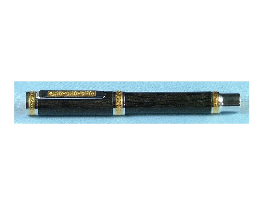

I agree with Frank, most lenses have a min distance you can be from the subject. I would guess that a couple of feet is to close. I shoot my pens from more like 5 feet away and use a tripod. I zoom in and crop the photo. Here is an example of the finished photo. originally the photo was the size of the white area.
