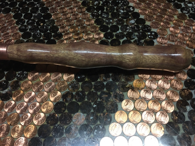

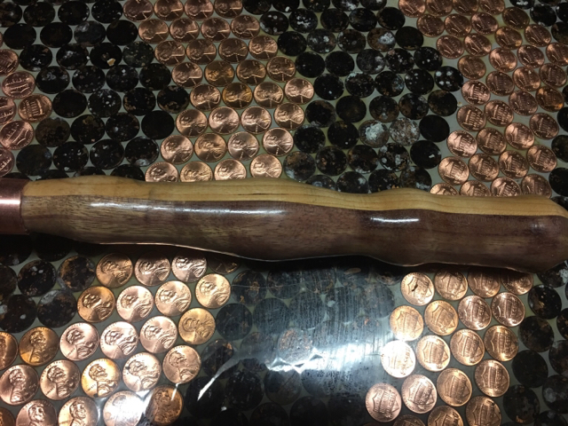

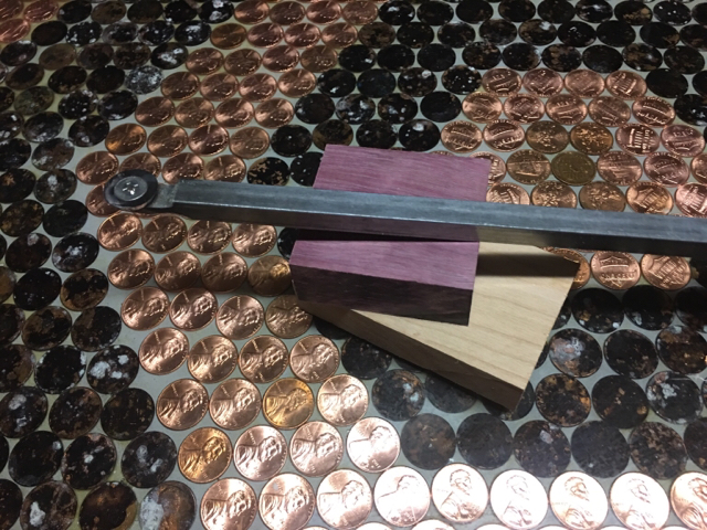

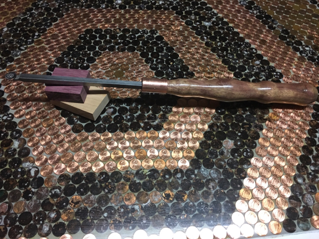

My first attempt at DIY carbide tool (making and using).
Turning definitely has it's issues but hopefully this will get better with the next two. 3/8 " bar stock, cherry and purple heart. Handle turned with the tool it now holds.

I used the bench grinder to create the recess. I'm still new to the forum but how are theses?

I actually bought 3/8 inch bar stock... $6 and change at Home Depot for 36 inches. That's enough for 3 tools sinking 4" and leaving 8" exposed. The drill and tap I also got from HD. The insert company stated M4 or M5 for the screw size. I went with M5. Couple things I plan on changing next set... 1/2 stock may be more comfortable (3/8 works fine though) and I would use the angle grinder to cut the initial recess and just clean up on the bench grinder to control the size a little better. The square tends to rotate during the initial tightening.
