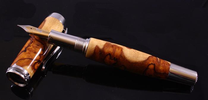

Had a special order from someone that got one of our pens as a gift from a customer. This will be a gift to the customer that bought hers. The wood is none other than Nolan's DIW burl. Doesn't get any better than that. Also the customer wanted a finer nib as the standard nib that comes with the Statesman writes a bit too wide. Well DCBluesman came to the rescue with the Heritage SF fine point which is .60mm verses the Dyacom .85mm. Can't wait to hear how it writes as the price for these nibs is great. Finish is CA and we will not talk about how many coats were applied. [B)] Needless to say the first several coats seemed to soak into the sap wood of the DIW. Boy was I wrong. Pain in the rear but probably the best finish we have done yet.

Looks great Mike. I wonder if a sanding sealer might have helped with the soaking in. But then again, it became stabilized.

In all seriousness here is what happened. Normally I put the calipers on all of the fittings and write the size on each little bag. I will turn the blank to .005 less than the fittings. Apply CA until I am .004 to .005 above the fittings and sand through MM until even with the fittings. Usually the first 2-3 coats of thin CA will give a blank a dull sheen and you can see the finish begin to build. This one did not so I thought that the sap in the blank was soaking up the CA. 24 applications of CA later you could see signs of CA on the surface. So I ran through the MM and checked with the calipers to see how much I needed to work up or down. Oppps[:I] CA was working fine on the build up. .021 above the fittings. So I sanded until it worked it's way down to flush with the fittings.
So several lessons learned:
1.) My eye sight ain't what it use to be.
2.) Check with calipers even if it doesn't look as it should.
3.) A typical sand through all nine grits of MM takes me 10 minutes and will take .002 off of the finish. [V]
Yes Ed, Linda does supervise me from time to time. If she did not I would be in worse trouble than I usually am. To all of you with your compliments than you. I love to work with this wood and Nolan always has such great quality.

Great looking pen. Your customer will love that nib. I have a customer now who won't buy anything else except the Heritage 18 fine.

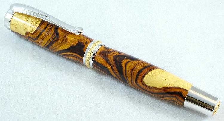

Looking for something like the one below. It has a little better color representation.
Mike

That is a beautiful pen and the extra time you spent on the finish was well worth it!
