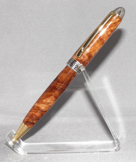

I don't make near as many pens as a lot of folks here. But I try to do them right and attempt to sell only top quality to my customers. I charge more for my pens than I believe others do for similar models. They are sold out of an upscale art gallery. I do not want unhappy customers or returns.
For my gold colored pens I use only Tn gold because of it's durability.
But, I have discovered there is another factor that can make an otherwise high quality pen qualify for a complaint from the customer. Namely, the supplier does not necessarily always ship what they promise.
The pen shown is one of my personal daily carry pens. It is a European in Big Leaf Maple Burl with Tn gold hardware.
You are going to ask, so I'll tell you, the kit was purchased from Craft Supply USA.
After several years of use, the 'gold' on the band and cap have completely worn away. The nib and clip are still in pristine condition as we have a right to expect.
It is obvious the band and cap were plated with something other than Tn gold. Probably 24K or 10K gold, neither of which has good wear qualities.
I believe when we order a Tn kit we should get all parts in that kit with Tn plating.
I will have to stop carrying this pen because my 'carry' pens are my best salesmen. Now, this one does not speak well of what I produce.
Color me angry.

I'd say it's possible that they got some parts mixed up and didn't do that on purpose or maybe THEIR supplier got the parts mixed up. But I would definitely contact them if you haven't already. At least let them know that you are unhappy. Since it's been several years, maybe others have complained to them and they know of the issue and are willing to do something about it for you.

Have you let Craft Supply know? After a couple of years of daily use they might not replace it but may send replacement band and clip cap. Their supplier may have not packaged the kit properly and mixed the parts. I don't know if I could tell the difference.

Perhaps you should contact the supplier with your problem. If you have, what was their reply? I am sure they would be happy to replace the product to your satisfaction.
I have not contacted them yet but will do so before the end of today.
I don't expect any adjustment. Really none is possible since the product (finished pen) is worth more than the sum of it's parts.
Since they offer a variety of bands and clips, I suspect they 'pick' the parts for kits and that the parts are of different platings. Not good.
Ummmm -- I may be wrong, but I don't think so. It's been my experience that kits come from Dayacom (or whoever) pre-packed, meaning all the parts are packed together in those little ziplock bags. If a non-Tn part wound up in a Tn kit, it probably happened in Taiwan. However, if you "mixed and matched" kit components (like the CB) from other sources, it is your responsibility to insure that the parts you included are Tn plated.

Not sure if the parts have changed over the years, but for at least the past year, the CSUSA Euro in Gold Titanium is not available in the "fancy" trim ring as your pen shows. The gold centerband from the Gold Titanium Euro looks like this:

If you look at CSUSA's web site this style center band is on their 10K gold pen. The Ti-gold pen has a solid stripe on the center band. With all due respoect, I think this is 10K plating - not titanium gold plating.

If in fact the plating is 10k or something else and you got "several years" of service, you did good. IMHO before slaming Craft Supply, you should make sure of your claims by contacting them direct and giving them a chance to respond.

The kit in question has been 10k gold at CraftUSA for at least the past four years. I have bought it in group buys for about $4.00 but sparingly because of the wear characteristics of 10K gold. However the same design in rhodium, which I prefer has been a little more expensive. I only bought the gold version when someone wanted the design in gold and they were made aware of the inferior wear characteristics.
Louis seems to have the best solution for you. CS has offered to replace the kit ith out question. If that is not a satisfactory solution to your problem, try to have future kits replated locally to your specifications. IMHO this thread has gone on long enough.
