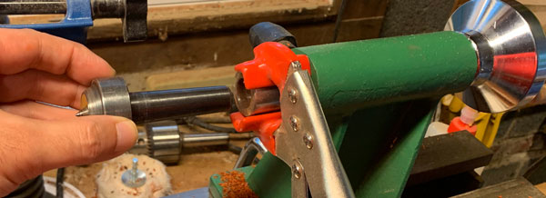

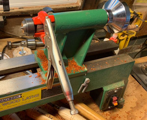

If you have soft-grip pliers for pen disassembly laying around and need to dislodge a stuck live center, try this.
The rubber grip holds the pliers in place nicely.
Turn the tailstock and catch the live center before it falls out.
I should have figured this out long before now!

Oh, OK ..... I think I get it ..... you turn the tailstock wheel so as to retract, and then the live center just pops out !! . . CLEVER !!! . . THANKS for tip !!
Your pictures are always superb !!

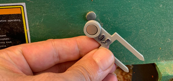

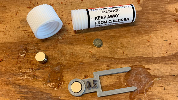

I needed to turn a lot of blanks down to 0.5" so I 3d printed a guide and glued a little earth magnet into it so it wouldn't drop or otherwise get misplaced.
These little earth magnets I picked up at HD are fantastic.

Regarding the Starship Enterprise...
Nice. I thought it was something magnetic. You certainly don't need to worry about calipers slipping that way. I use magnets for a lot of stuff. There's always pieces of sandpaper all over my lathe stand, though the magnets aren't attached to the paper. Handy for making sure those little chuck jaw screws don't get lost, too.

I have a couple of centers like yours which have a short Morse taper which will not self eject when cranking back the quill.
I simply lay a wide skew between the tail stick and the back shoulder of the live center and like your method, the center will then eject when the hand wheel is backed up.

Old thread that I just happened to see .... thought I'd add my 2 cents anyway. I turn and teach at a non-profit makerspace so we've acquired a collection of various lathes and various length live centers. Happens a lot on the Oneway 1224 and to make matters worse, it doesn't have a tailstock hole so using a knockout bar isn't an option. My solution ... extend the tailstock quill and lay a 2" scraper flat on it then crank down the quill and the center pops right out. Same method as your vise pliers but not everyone has those.
I actually use this same trick on other lathes. Sometimes the live center get stuck so tight that even a knockout bar doesn't work well (without going flying across the room). This has always worked for me on several different lathes.
