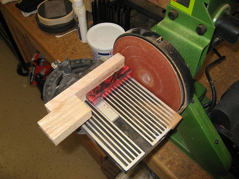

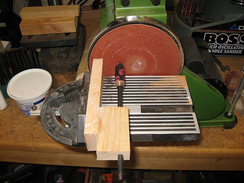

I have always used a pen mill to square the end of the blank, only because I do so when the blank is still square. What is the technique used to square a blank with a sander? Or, does it really mater if the blank is stil square of round? If you use a sander, how do you index the tube so it comes out square on the end? So sort of jig? Sorry for all of the dumb questions but, hey, maybe I'm missing something here with the sander.
Bill
Dave Turner
Jul 23, 2010
417
Sylvania, Ohio
I added a larger fence to the miter gauge to make it easier to keep the blank square to the disc. I drill on my lathe with the blank held by my chuck's pin jaws, so the hole is parallel with the sides of the blank. If my blank is irregular, I can always slide the blank onto the squaring rod (an unused mandrel rod now that I turn between centers). I glued a wood rod holder onto the miter gauge fence so that the rod is square to the sanding disc.

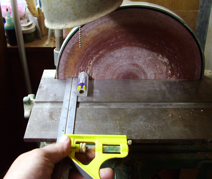

I have a cast iron delta 12" disk sander with dust collection it is a work horse
Rockler has them on sale now and then
I simply clamped a 1"x6" piece of wood at 90 deg to the disk and hold it in place sq with a bessey clamp simple and effective
I sand a blank until I hear it barley hitting the brass and then i do a few twists with a pen mill This works really well and it's quick
You will use a disk sander a lot for all kinds of tasks
The heavy cast iron combo units with a 12" disk will run you $1200 that is a lot for pens the less expensive combos will be at the expense of the motor on the disk sander so keep that in mind
