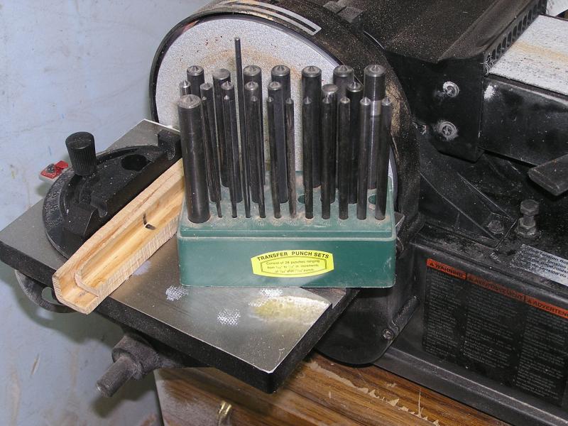

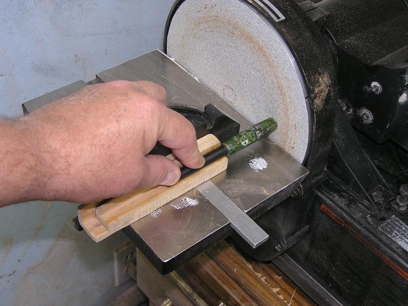

I use a simple bench disk sander, a piece of wood corner mold and a set of harbor fright center punches. Works great just be sure everything is square.
A photo is worth a well you :rolleyes:

I do it that way to, but only for a half a second, !!DAMKIT!!. I have a late eighties heavy cast iron floor model 9"disc & 6"x24" belt with 1hp motor belt driven. Thing is heavy. Never used it much till i started making pens and turning small stuff. It also works out great for laminate work to. Carl

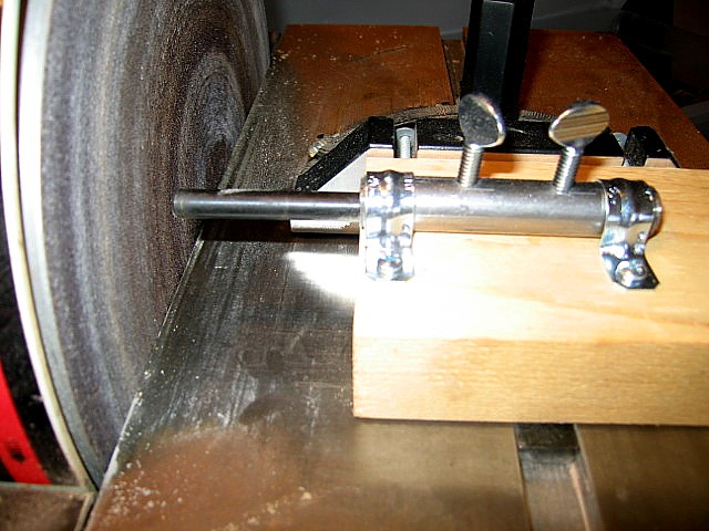

Marc Phillips
Jun 1, 2004
900
Columbus, GA, USA.
Squaring jig
Here's the set up I use.... It had the advantage of being able to do all different sizes. I just change the Transfer Punch (from harbor freight) to fit the size of the pen I am doing. The metal tube (just some conduit) is round and the transfer punch is round so the rod automatically centers when I tighten the thumb screws. Works great!

BigguyZ
Aug 8, 2007
764
Minneapolis, Minnesota, USA.
Marc,
I was going to make the jig Jim referenced for the lathe, but I think this might be even easier. Very nice. :)
