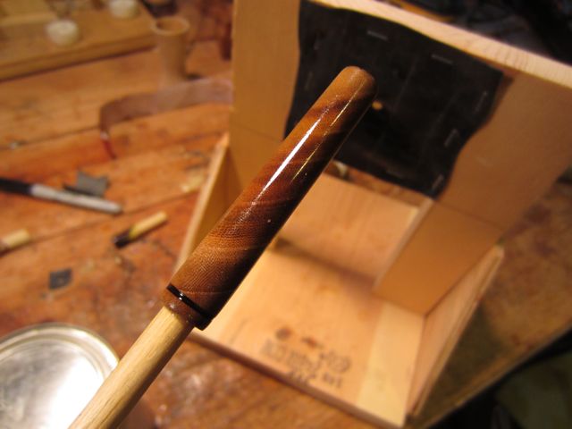

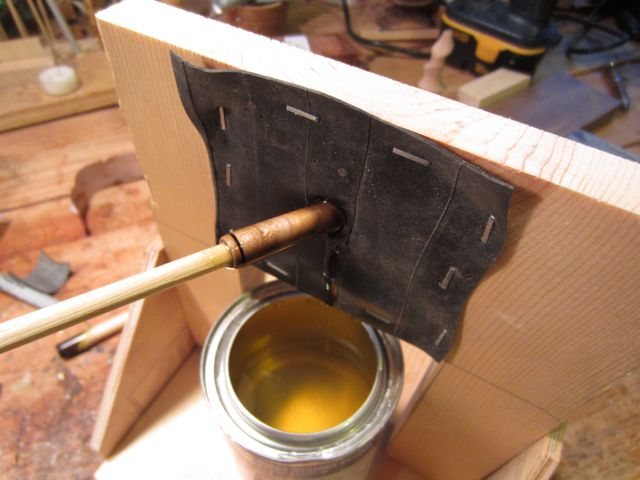

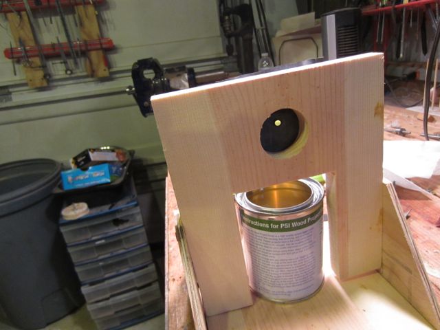

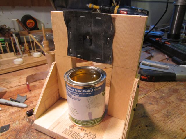

BAsed on my initial experience with the dipping method AND my previous experience with Arrow finishing I made this rig. The result was a perfectly even finish which was dry to the touch in 2 minutes. I figure two or three quick dips then let it cure for a day. I think I have finally found the perfect balance between quality and time.

Which dipping finish are you using?

How big was the hole in the rubber inner-tube?

This has two advantages over the 3-Rivers.
First of all it is FREE!
Second the arrow dipper is designed with you holding on the the last 1/4 inch which will be cut of for nocking. Obviously this is not ht case with a pen.

Would it work if you put the tube over the can opening and pushed the pen through the tube, into the coating, and pulled it back through the tube?
