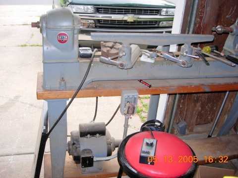

Any ideas about using a router VS - "dimmer switch" for a 3/4 HP Milwalkee-made Delta/Rockwell lathe? The lathe is 8.6 amps and the switch is supposed to be good for 15. I know this baby is filthy, but it should clean up nicely.

I don't think it will work unless your motor is a universal motor.

It ain't gonna work!! Those switches work on Universal motors (the ones with brushes. won't work on induction motors (the kind on most all stationary woodworking tools. Sorry!!![^]

For example the on the Jet Mini its an AC motor on the normal version and DC on the VS model. I think if your motor is AC it will not work... but I sure am no expert!

Totally agree with the above. Router speed control works with UNIVERSAL motors, which have brushes. The motor in your pic has a capacitor (the bulge on top), and both control and motor can burn out.

That's a good lookin' lathe. Nice and heavy. The motor is an induction motor not a universal motor (which is what routers have) as others have said. If you use a dimmer switch you'll damage the motor. If you need a different range of speeds try a pulley with "more steps". This link shows how to determine spindle speeds http://woodmagazine.com/wood/story.jhtml?storyid=/templatedata/wood/story/data/414.xml
