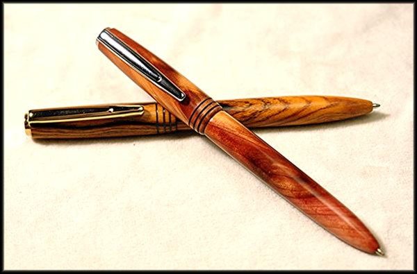

RussFairfield
Passed Away 2011
In Memoriam
Feb 10, 2004
1,522
Post Falls, Idaho.
How about 2 of them??
<br />
Daniel
Jan 1, 2004
5,921
Reno, NV, USA.
Well now Russ, that photo is just loaded with ideas of how to deal with the wood meets metal issue. no nib, no center band, looks like the clip end was left proud in an intentional way (looks good at that).
looks like this pen wouldn't even have a brass tube in it.
it does raise one question in my mind. have you ever noticed a problem with the clearance at the center band, (due to expension of the wood)?
I know I've had problems in the past making the lower barrel even a bit to large and using the metal band.

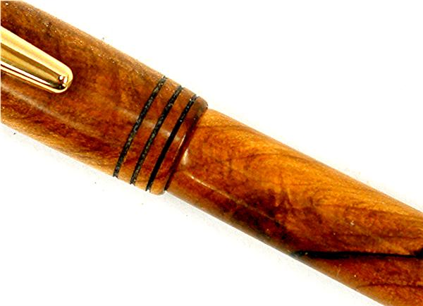

RussFairfield
Passed Away 2011
In Memoriam
Feb 10, 2004
1,522
Post Falls, Idaho.
Daniel asked about wood shrinkage at the center band of the pens in the photo. I don't know whether this is the answer he wanted, but there was a problem and this will describe how I solved it.
I had been making these pens with a butt joint between the two barrels, and someone asked why I wasn't recessing the lower barrel slightly into the end of the upper barrel. I hadn't though it necessary, and had always assumed that the butt joint was OK. But, the question nagged me, and I started looking more closely at the pens.
I discovered that I had a problem with the wood shrinking back from the ends of the brass tubes. Not only was there a gap between the barrels, I could see the shiny brass tube at the bottom of the gap.
Thinking about this, the shrinkage in the long direction of a piece of wood is small compared to that the radial and tangential directions, but it isn't "Zero". The number is something like 0.5% to 1% for most wood. Now, 0.5% of a 2.5" length is 0.012" or 1/64", and that is a significant gap that is visible. When the shrinkage is from two directions, the gap becomes twice as wide and a 1/32" gap is really visible.
When the pen is made with the wood at an angle or a full-cross grain, the larger shrinkage in the other directions becomes significant and the resulting gap can become large.
I could explain away the gap between the barrels because the burned rings on the upper barrel sort of disguised it. But, there was no forgivness for being able to see the brass tubes at the bottom of the gap.
The solution was simple. I now recess the lower barrel into the upper with a 3/32" taper joint. The gap disappears, and there is no way to see the brass tubes. The joint looks like this photo, and you can see the beginning of the taper on the lower barrel. It slides into a matching socket in the upper barrel.
<br />
All of this has made me aware of "gaps" and I starting seeing this shrinking of the wood away from the metal fittings on a lot of pens, particularly on those where the grain is at an angle or cross direction. It was easy to solve with this pen, but how do others solve the problem with pens with captured fittings, or is it small enough to be insignificant? Am I the only person who sees these gaps?
