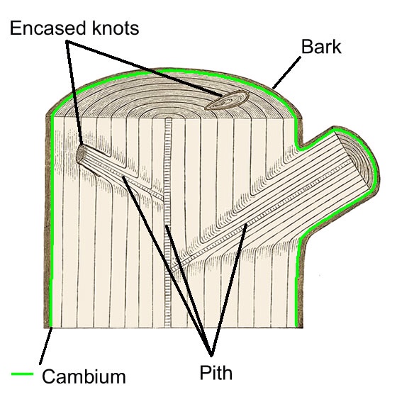

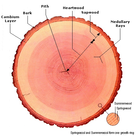

`Pith`is the soft wood at the center of the tree or branch , generally the first years growth .
Knots are almost always harder than the surrounding wood , but the attractiveness usually makes up for the difficulty . Pine is frequently maligned for being too plain , but it`s knots are not .

Hmm ... I've always heard of the very soft wood layer just beneath the bark (between the sapwood and the bark) as pith, or pithy wood ... Looks like the proper term for it was the Cambium ... :)

Well that picture depicts the perfect world. As others have said it appears as though you are dealing with a knot. That's a branch that looks just like that picture only inserted sideways. You are at the crossroads of two of those pictures combined at angles.
Makes for hard, soft, and everything in between when turning, it is also what makes for a beautiful piece of wood. On some of that stuff a chunk of 60 grit sandpaper may be the answer.
