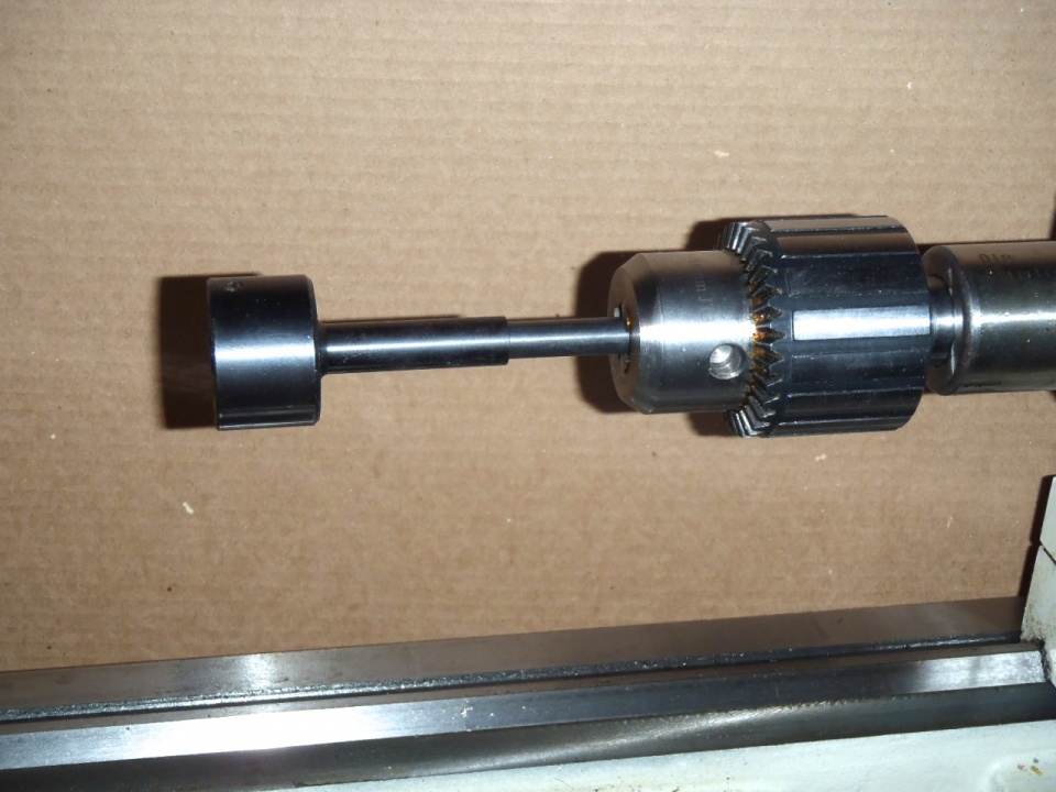

I have one and I must be the only silly enough to put a pin in the tail stock chuck and slide the die holder over it and spin the die by hand, letting it self feed over the pen part. I don't know if it would work on metal but ebonite and plastic are within the range my wimpy grip. ;)

Pete,
Sounds like a great idea. Could you explain the "pin" and maybe provide a picture? Thanks in advance.

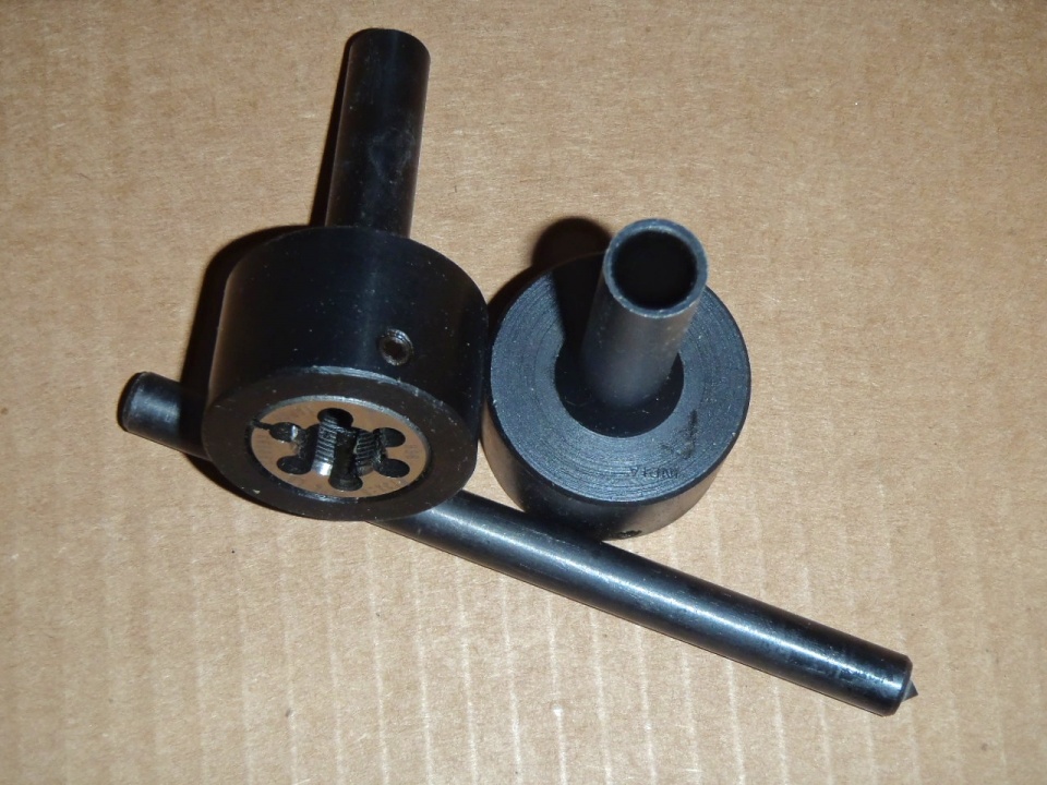

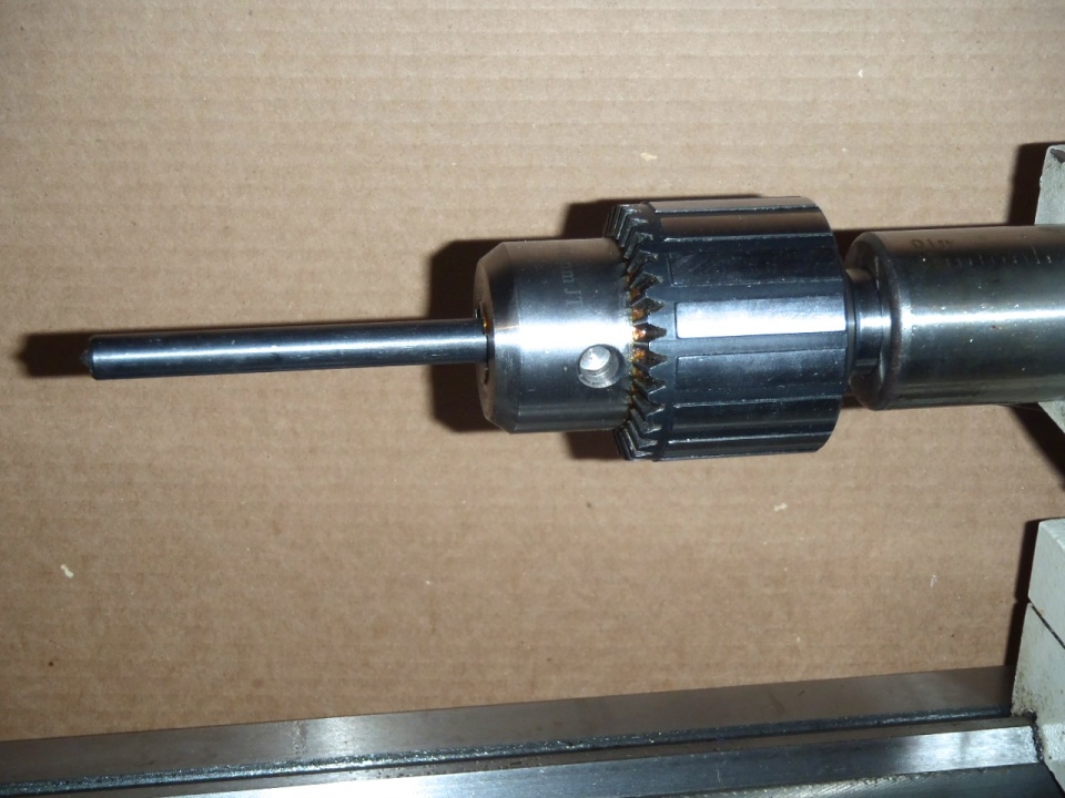

I use the nearest transfer punch that fits the hole. :) A chunk of hardwood turned to size will work in a pinch. :wink:
The pictures are quick and dirty because it is close to freezing in the garage. :rolleyes:
