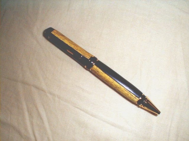

OSCAR15
Mar 14, 2006
479
Winder, Ga, USA.
Tried several suppliers...Happiest with Pen State Industries. Also, as was pointed out here, you can get a free DVD on turning pens...Highly recommended. It is enough info to show you the way to get started.
Other than that, follow safety issues and above all..have fun! OSCAR
