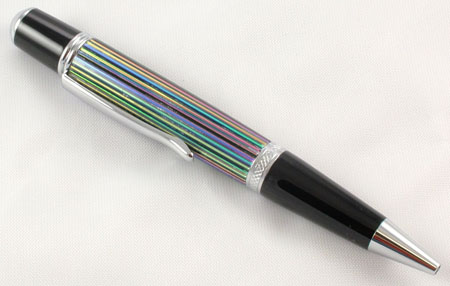

Ok. Thanks for the info. I didn't realize there were so many different kinds. I have seen the striped ones and that's what I'm looking for, similar to this one.
I was thinking it would look good on a capped fountain, probably a Gent.

It would look GREAT on a gent, but there is not enough material left on that kit to allow the rods to be inserted. That's why we used the sierra vista.
(You may see a couple on different kits. I did a few and I think Lou did too. Not an application we would sell--potentially high failure rate)
