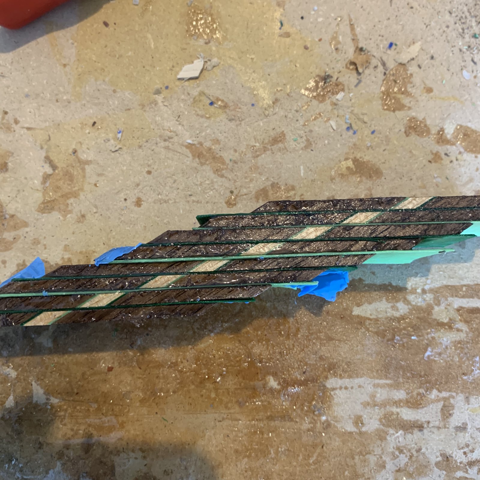

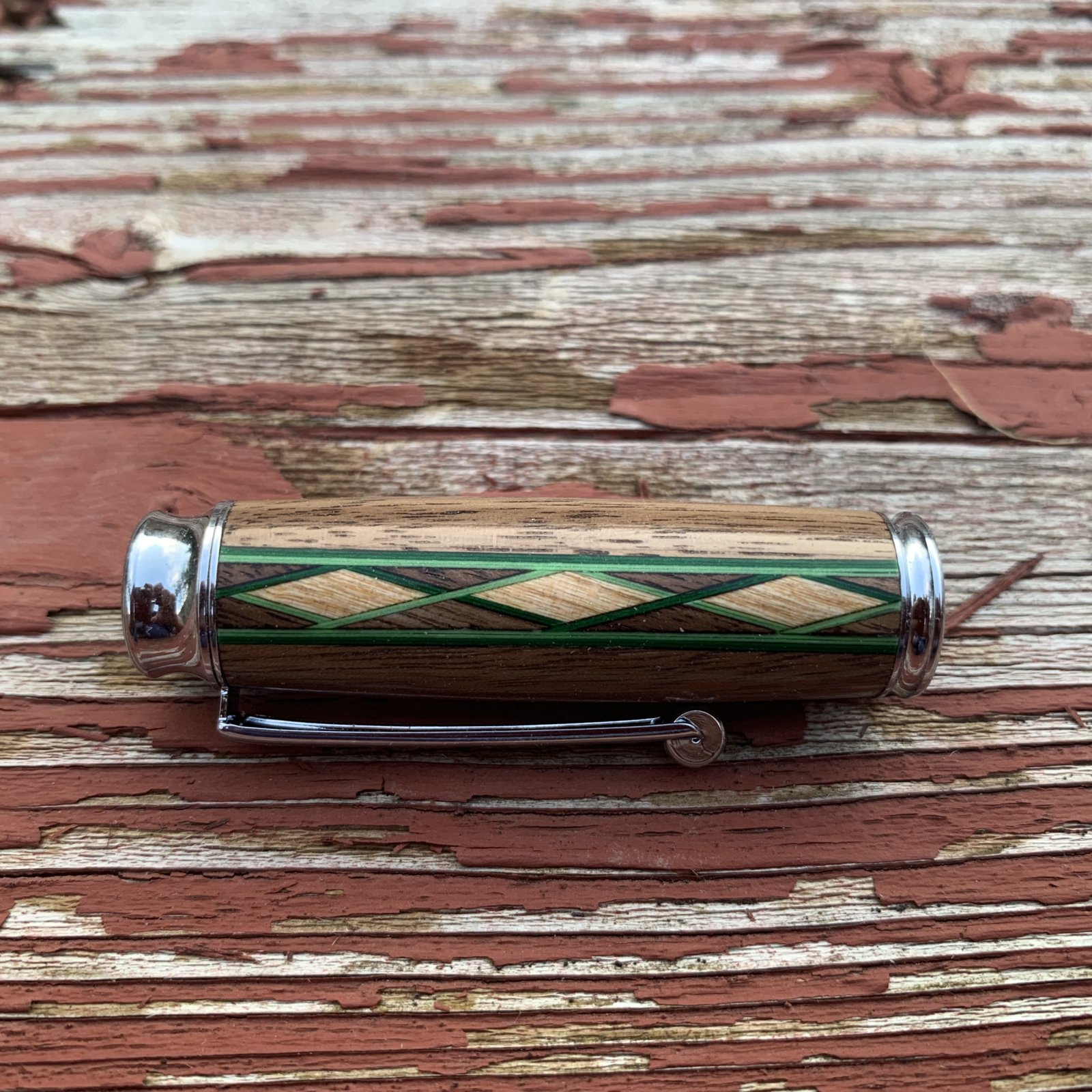

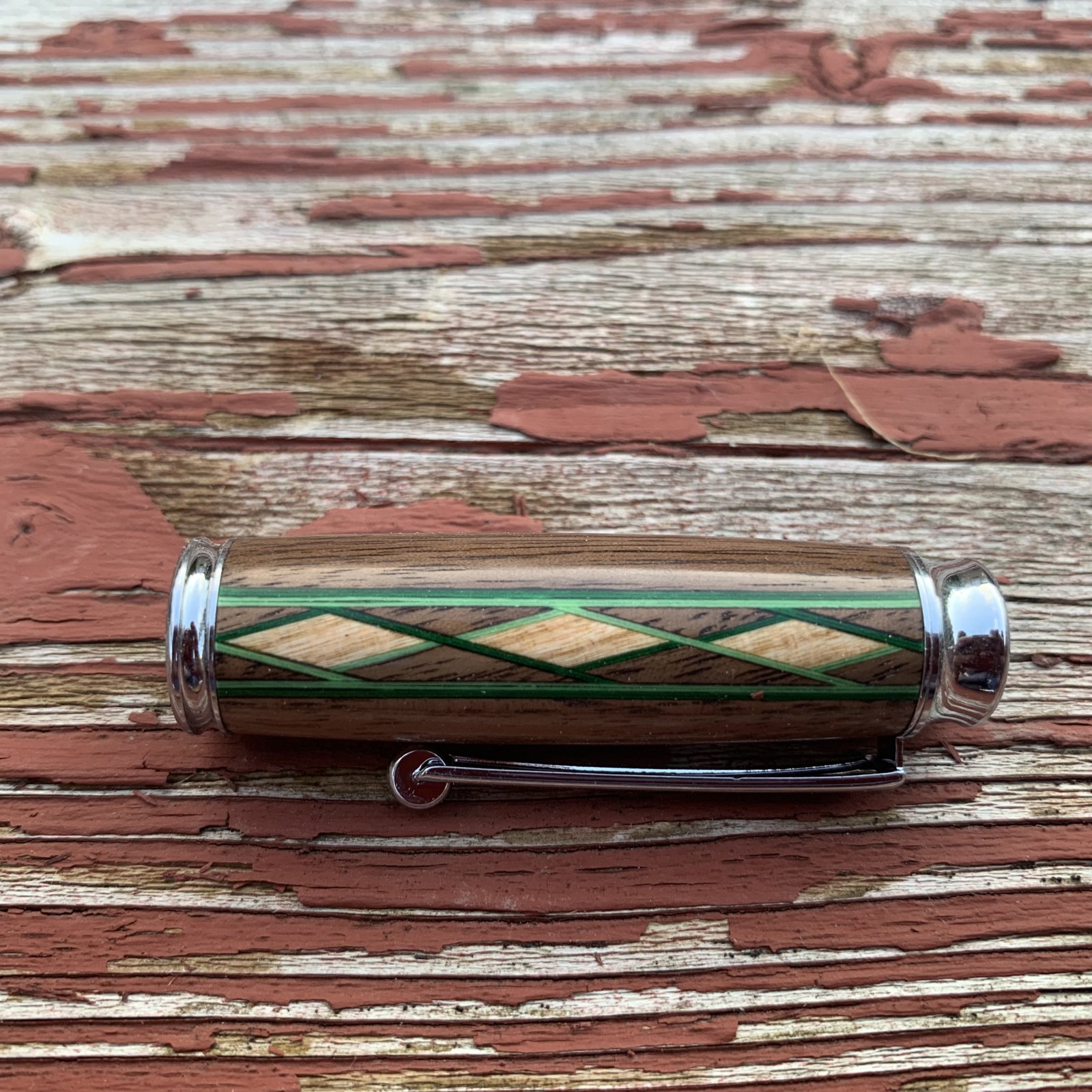

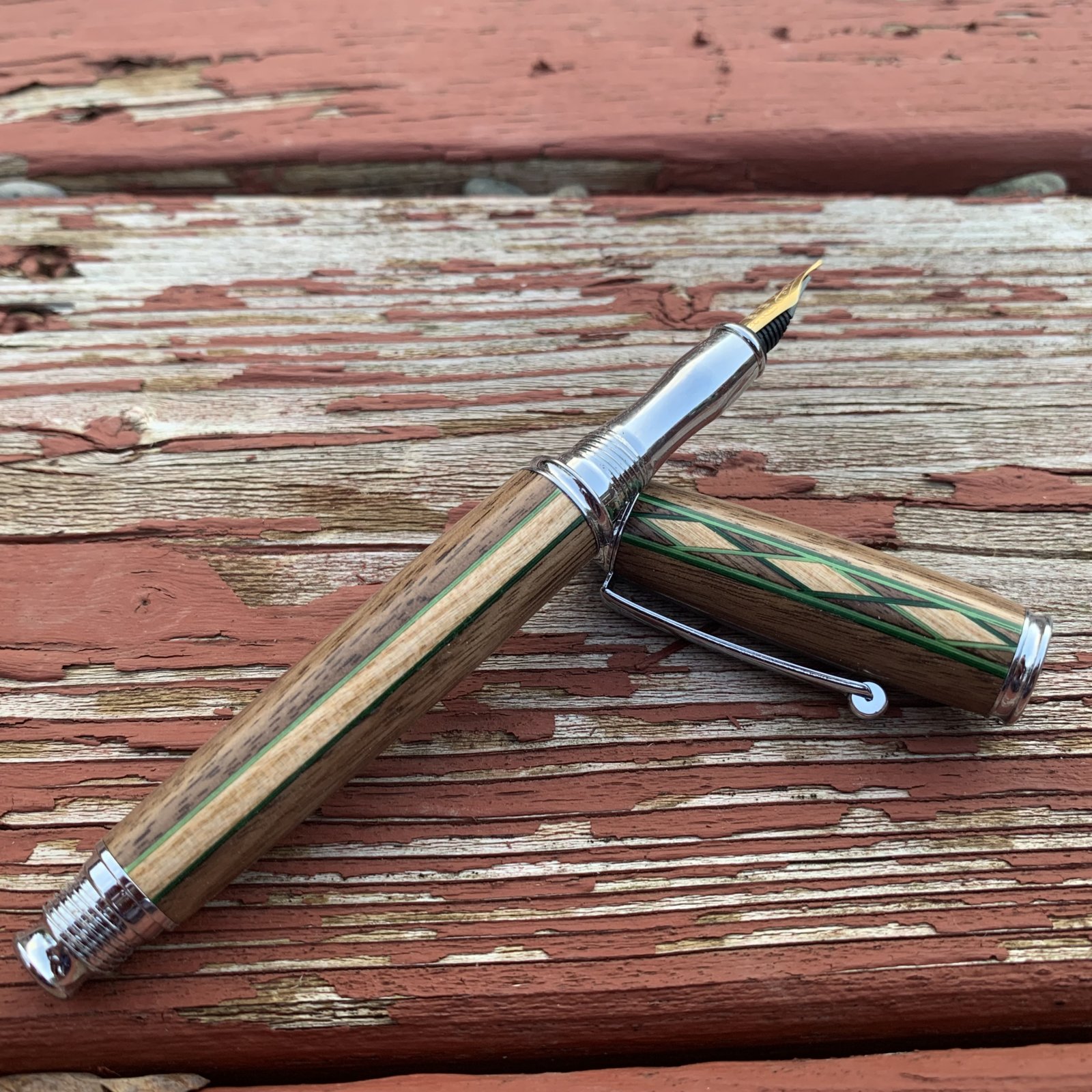

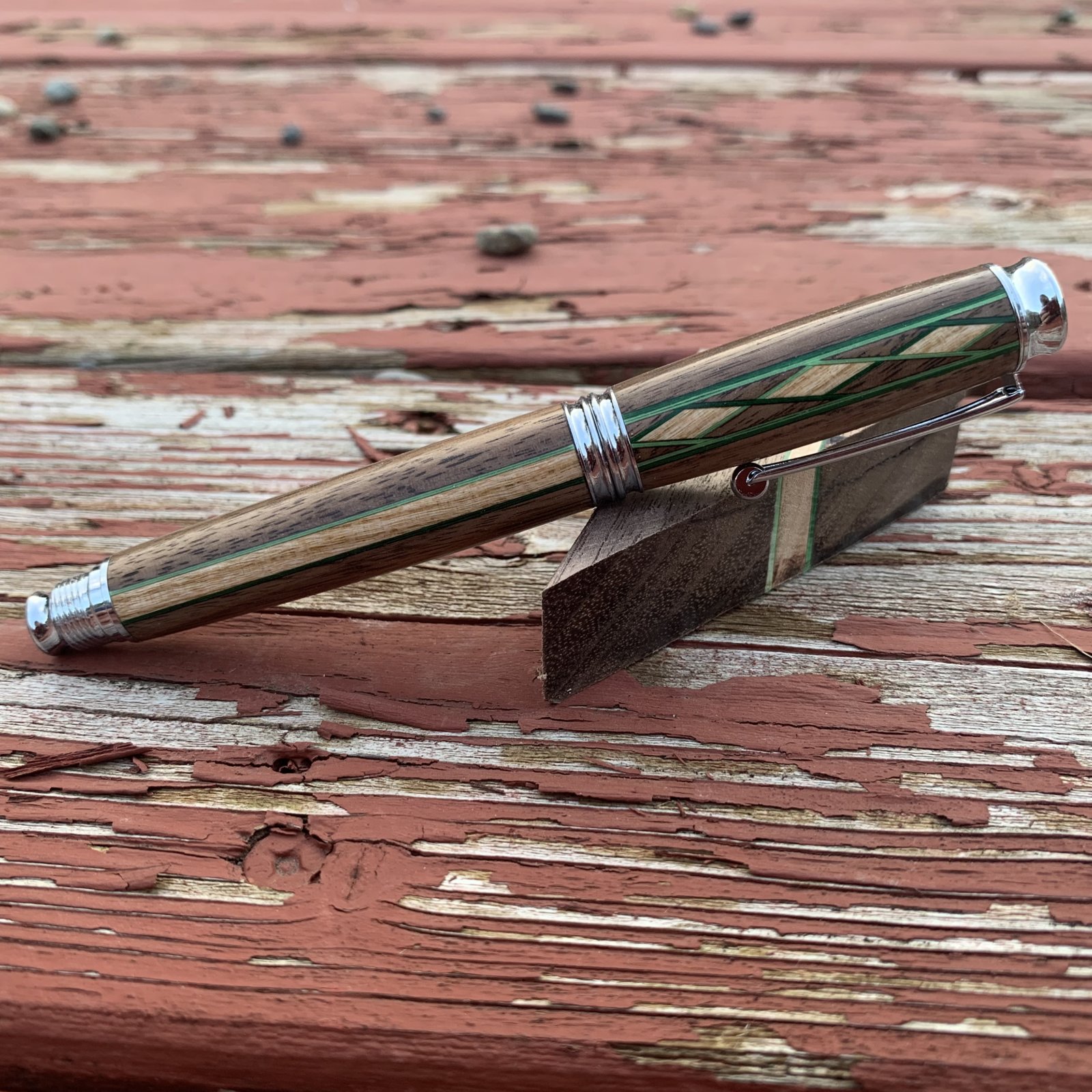

Here is my jump into the diamond adventure. I had a couple of issues and this is my third attempt. Still not completely happy, but I like it. Comments and criticism always welcome.

I like this and I think you can easily hone in on the sharpness of the cuts more and really tidy up the diamonds. Just out of curiosity what is the angle used to achieve that. I like the green outline to offset the colors. Nice touch. Again my segmenting heart strings are being tugged at. I revealed one of my suggestions in another thread just posted with diamonds but the user is using square diamonds which is alot easier.

Thanks. I do need to work on honing my cuts. The angle is 60 degrees.

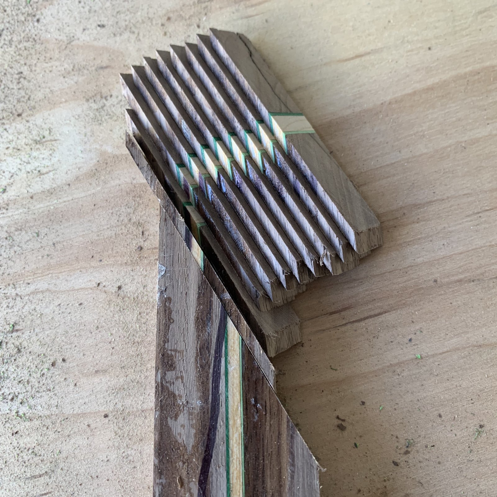

I use a jig on my table saw set to 60 degrees to make the slices. The piece that I am slicing up is always way longer than I need. This was my third attempt and making the diamonds and body of the pen is made from the leftover chunk.
after glue up. I used my table saw and the microjig grr-ripper to push this through so may hands don't get close to the blade. Until one side is cut next to the diamonds.
Then I glued the sides stripe and outer piece on so it is thick enough to work with. Then repeat the process on the other side.
I would not feel comfortable cutting the stripe on miter saw. Everyone has to find the process that makes them comfortable. So be safe.

Angela, you state that your not completely happy with the outcome, well i'm sorry, but I think your being a little to critical of your own work. It's a gorgeous blank and now pen, I'd be over the moon, if I could get an outcome nearly this good.

Well done Angela! I find the diamond cuts to be pretty simple, it is lining up the edges to square them off that stresses me out! Like you, I do one side and then glue up the rest of that half, with lots of extra to keep my hands clear. I do have a Byrnes table saw, and that makes it "seem" far less dangerous. I do like the green accent. Thanks for showing how you accomplished it.
