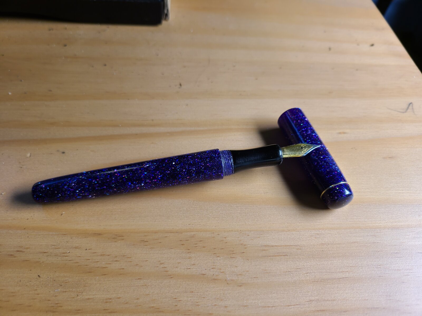

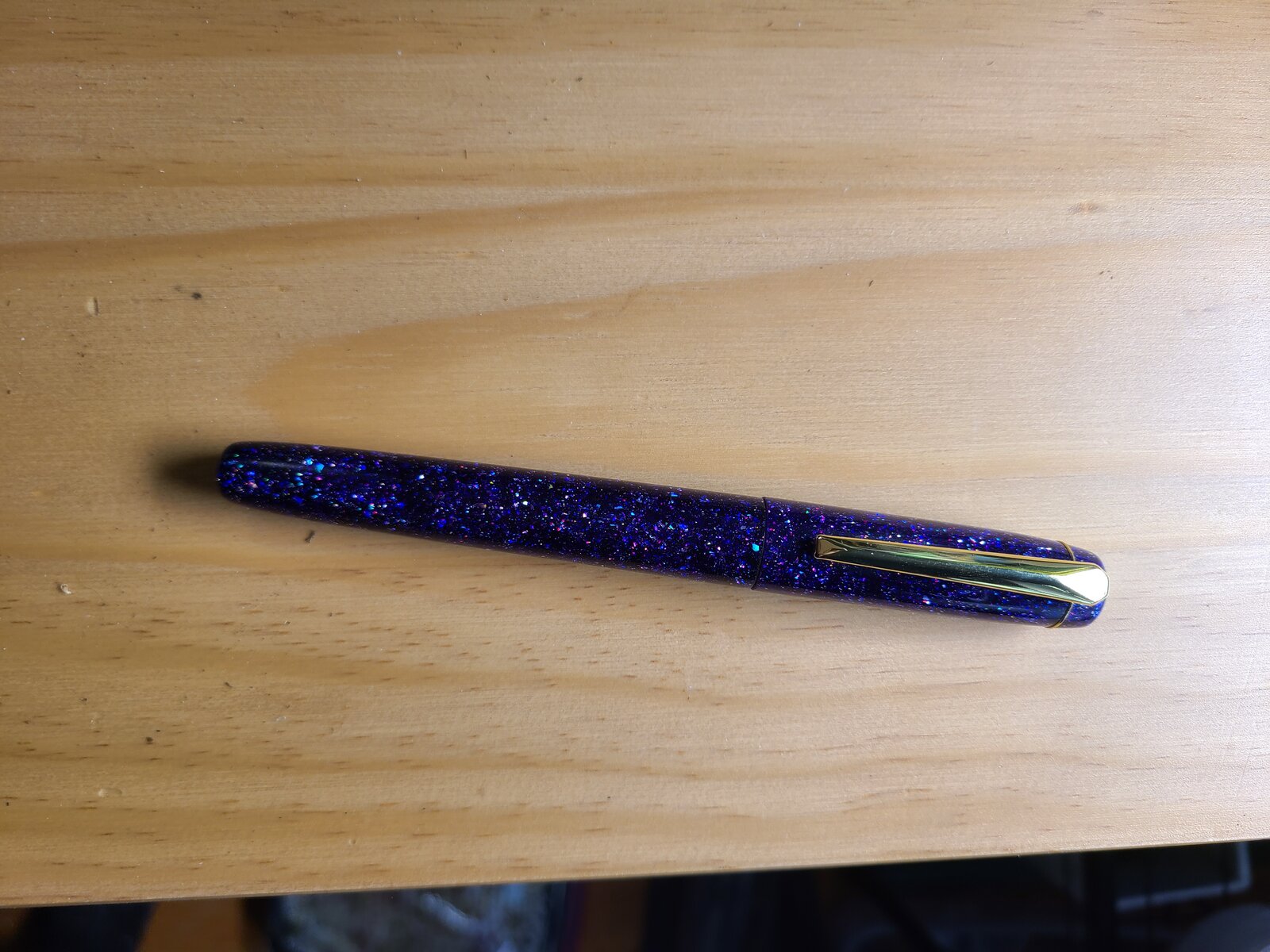

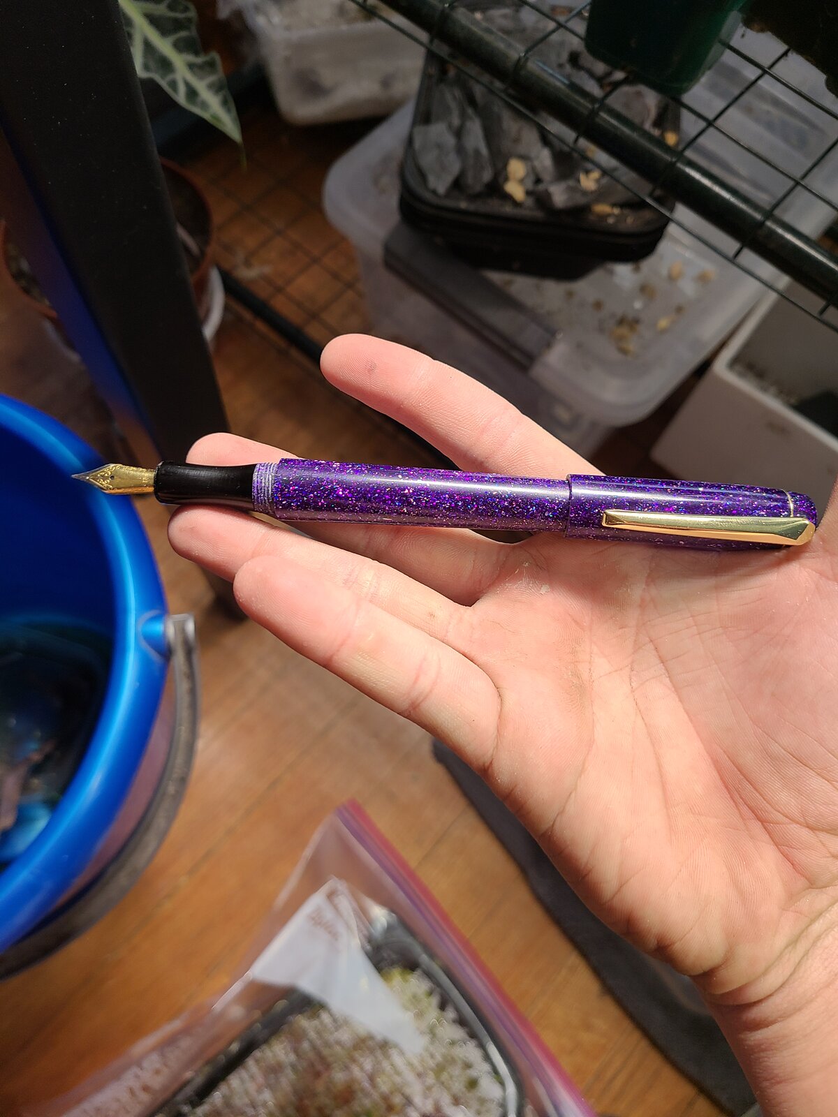

Recently saw some gorgeous hybrid blanks on etsy but was too lazy to spend money and wait for shipping so I satisfied the urge by digging up a blank I had and finishing off the rest of my ebonite with this pen.
Somehow lost my calipers so had to go back to eyeballing my measurements. Ironically this is the easiest kitless I've done. Didn't mess up even once which is a first for me. Confidence riding high until I see the works of art that are on here made by everyone else.
I especially love the rainbow holographicness of this blank, makes it look like it's bigger on the inside even though it's a solid piece of plastic
Also recently got a buffing wheel and makes polishing such a delight to do, makes for such a nicer finish too
Nib: JoWo #5
Threads: m12x.08 tpl cap and body, m9x.75 section-body threads, m6.5x.05 nib threads
Clip is one I stole from another pen of mine
Nib: JoWo #5
