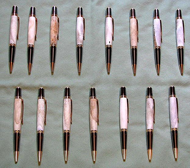

Karl,
It is kind of interesting hearing all the down side smell comments about antler. My experience has been quite different. The stuff I've used (thus far moose, deer and a touch of elk) has had a bit of an odor when cutting on the band saw (though not that serious). And it is a little more pungent when drilling. I get nearly zero odor when turning or sanding. There may be a few things that affect this.
First, I have used only antlers that have had a chance to "dry" for at least a year. The three deer antlers used for these pens were decades old. I can tell you from first hand experience that fresh antler sheds (moose antlers) stink to the high heavens just handling them. We left a pile of fresh moose sheds in our camp for a week and when we returned the place smelled as bad as the north end of a southbound skunk.
Second, I have a 16 gallon shop vac I use for a dust collector (in a spare bedroom no less) but it has a blower port and I vent it outside through a homemade port in a window. That may remove some smell and might explain why I get the most smell when drilling. My lathe had a hood and I connect the band saw to the dust collector, but the drill is only vented passively if I turn on the dust collector on the lathe beside it.
At any rate, I've yet to get a serious smell problem from most of the antler I've used.
