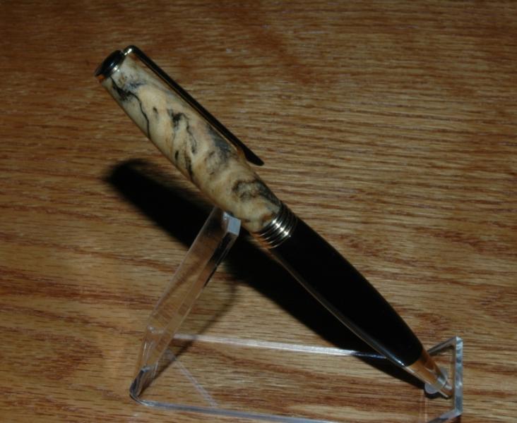

This is not antler, it is spalted pecan. But I chose to add a solid acrylic blank to it, since I had ruined the other half (this stuff was like balsa wood, so I saturated this blank to help in turning). I liked the combo well enough that I did another just like it, on a European pen (from Woodcraft, a gold kit with the black acrylic cap). Maybe a combo like this would work for you with your single antler blank. I've only turned two antler pens, and the first polished beautifully with just wet sanding with MicroMesh, followed by a little plastic polish. My second pen's blank had a porous dark patch, so I used CA to just fill and toughen the problem area. Again, just MM, followed by some plastic polish.

That pen is a slimline, with the black-striped gold clip. I really am not too fond of slimlines, so the center band is from a Streamline kit, to make it fatter. (I have a supply of the Streamline CBs to replace the standard CB that comes with the slimline.)

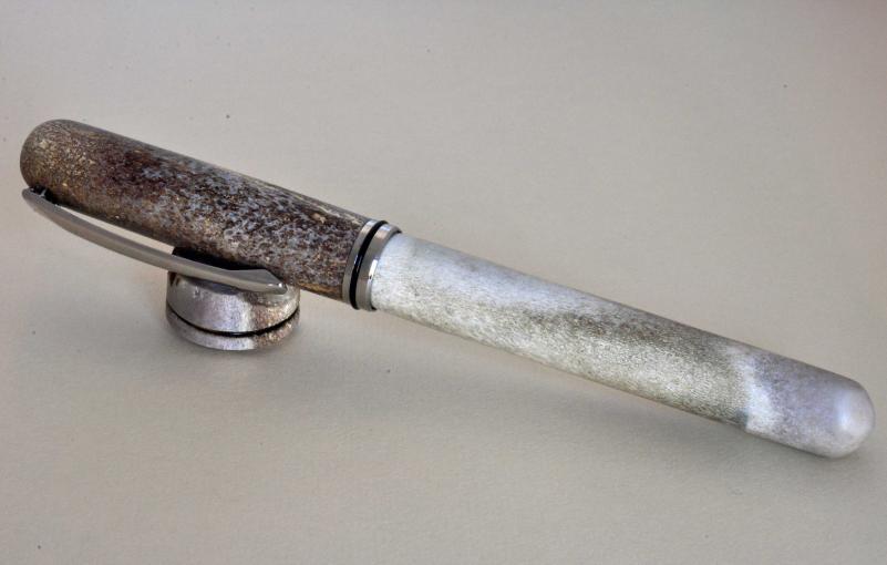

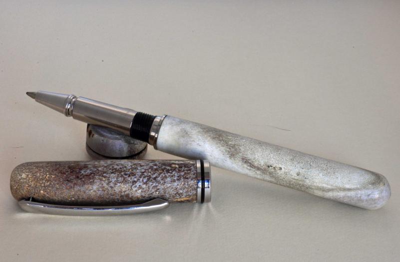

I got on to a deer antler kick a short while back; I did several Jr Gent's (I) … this is my favorite of the bunch.
