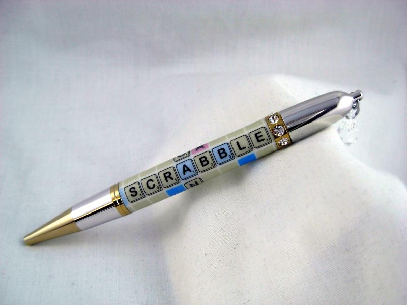

I have used Avery see through label sheets. They are a little more of a matte finish. I've attached a picture below of a cast label. I printed a label simulating a scrabble board. I calculated the length it needed to be so I could get a full wrap.
Man, that is one good looking pen! Love the job you did on it.

Jeff, I remember seeing this pen and it still looks great:) I want to cast with resin so I want to use a painted tube and place a decal or label on the tube and have it cover the entire tube. I am going to have to learn how to make the decal fit the entire tube. NewLondon gave me a starting point with some math work. Now all I need to find is a nice clear colored waving flag.
Jeff when you did that did you think about the consequences of trademark violations or is there any??? Also is it possible to see the seam and how you handled that??? Thanks for the reply.
The Avery labels are fairly thin and with the pattern of the "board" I was able to overlap slightly. I wrapped the label almost completely around and then trimmed as close as possible, leaving a little overlap.
As for trademark, I didn't use any logos. Just put the word scrabble on a patterned background :wink:. For the sake of one pen I don't think the board game gods will strike me down.

As for seams, you'd do well to try and incorporate it into your design. People
tend to look for seams at the bottom of an image. SO .. put it somewhere
else! A design that has lines is great for hiding a seam.. so are designs with
black backgrounds. The Scrabble pen (love that one!) is a great candidate
for hiding the seam. Since the image will wrap around the entire tube, you
can shift the image so that it starts about halfway down the page, and
continues down from the top (as compared to continuing on the next page)
so people won't be looking for the seam where it is . They'll look for it where
they EXPECT it to be, and they won't find it.
