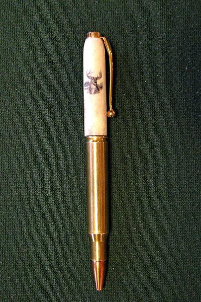

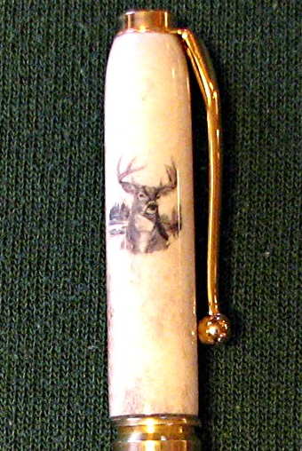

The first pen is an antler/cartridge pen using the same deer image that Jeff used (very nice image). In another try, I would ease off the darkness of the image (more charcoal/less black) as I like the "ghosty" appearance of Jeff's pen better. Still, overall I was not displeased with the result for a first try.

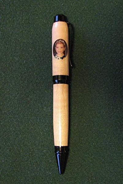

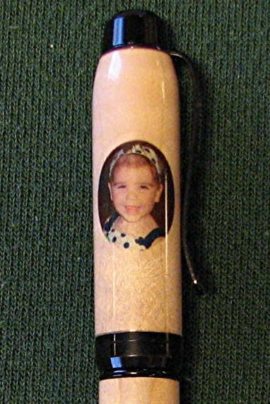

The second pen in a maple cigar that I made about a year ago to test the black chrome plating. My wife adopted it and uses it daily around the house. Since our son and his family recently moved to NC, I decided to try adding a picture of our granddaughter to that pen so it might have more meaning to her. BTW, the black chrome still looks great.
Both decals look pretty nice from a layman's point of view. For someone who is concerned with detail (aka, moi), the edges of the decal are visible in most areas as the pen is turned and examined in the light. I'm hoping to learn/find a way to reduce/eliminate this.
