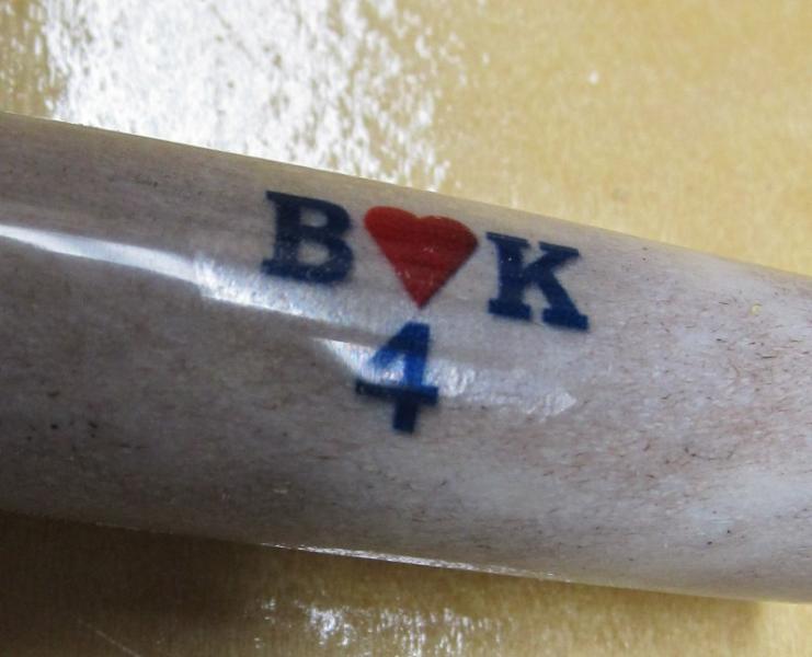

Here is a pic of my first decal attempt (on antler). The decal is quite noticable under the CA. A pic doesn't really show it well - it just looks like the area around the decal is rougher then the rest, but the issue is under the surface.
So, what did I do wrong? any thoughts?

A peel and stick decal? Issue was probably the adhesion of the sticker was not super tight even though it stuck well. The adhesive is comparitively thick and needs rubbing in to get complete contact. Even then it may have problems. Did you use thin CA as your first coat?
Best quality is going to be the water transfer type described here and there in the forums and I'm sure folks experienced in that will drop in and share some better knowledge with you. Good luck!

I agree with getting some thin CA down BEFORE you put the decal on. I've done dry rub-on transfers, plain old stickers and clear stickers and they all like thin CA first.

Maybe did not get the bubbles out first and making sure it is completely flat and dry.

Its a waterslide decal. I did put CA down first, but only gave it a quick hit with MM and I doubt it was fully smooth. I'll go through my regular MM routine like I was finishing the pen and try again.
I wasnt sure if it was that or too much bonder, but seems to be a consensus here :)

I agree with all that. Make sure you have a completely smooth surface on which to apply the decal. Use the water slide decals, clear or white, depending on what you are doing. I use a wet paper towel or my fingers to press out all the air bubbles and get the decal firmly in place and make sure the edges are smooth. This takes a good bit of water being put on the surface and i would let the decal dry overnight before putting a finish on it. I use thin CA only. It may take 10 coats of thin to completely cover the decal and make it impervisous to sanding with micromesh.

Second attempt was an improvement, but still not good enough. So, I just turned it off and put on attempt 3 (attempt 3 not counting crinkled and backwards decals lol).
Hopefully 3rd time is the charm. I just wish I got more than one try per day.
This last time I wiped some decal glue onto the blank from waste parts of the deal, then balanced a good bead of water on top of the blank and applied the decal through the bead. It looks promising, so fingers are crossed :)

Ok, this is frustrating. Third time was not the charm. Looking at the decal right after application I thought I had it, but no. After finishing it is no better than attempt 2.
So, I have a couple questions.
1) Is it really possible for the decal to not be visible, or are my expectations too high?
2) Could CA outgassing be causing an issue? No mention of a waiting period in the research I did, so just wondering.

I don't ca over the decal till it is good and dry, wait overnite. Most of mine are well hidden when finished. How many ca coats are you putting on?

There are a couple things that will cause the decal to not disappear under the CA. If the layer of "fixative" on the decal when you created it is too thick then the decal does not have the flexibility to settle into any texture on the surface you apply it to. Also, even on a perfectly smooth surface, the thicker the decal film (with fixative) the more likely it is to show up under the CA.
Another thing is the gloss on the surface of the decal vs the gloss on the surface of the pen. It has been my experience so far that if the CA is not polished and the decal is glossy it tends to show up more. You can either MM the surface to a gloss before applying the decal or use a flat clear when sealing the decal....kinda depends on the final finish you are trying to achieve.
How long are you waiting between applying the decal and finishing the pen. I always wait at least 24 hours.

I think I was washing too much of the glue away with too much water adn too much soak time. I finally got an acceptable result, but it took a number of tries.
I finally did a minimal soak time, then put just a speck (much much less than a drop) if water on the blank before putting the decal over it. I also pressed it down with a dry paper towel (press, not rub) instead of trying to use water to smooth it out.
I have the feeling this might be a little liek a CA finish. Everyone does it different and you have to find what works for you.

As Gary said above, The fixative needs to be as thin as possible for two reasons.
1. A thick decal will not "flow" around the barrel as easy as a thin decal. Also, with a thick decal you are more likely to have a rough edge when you trim the decal. The rough edge will be harder to hide in finishing.
2. The thicker the decal, the more you have to build up the finish around it to hide it. Polish the undercoat to a hi-gloss.
I find the method described in this YouTube video from one of the IAP members (ribanett) works real good.

On the lazer printed decals I have found if you will print the image reversed then soak the decal in hot water and apply direct to a smooth surface they seem to work better. That makes the ink on the bottom so it don't smear when you apply the CA. When the decal goes through the lazer printer it heats it up a lot and make the film a little more brittle. The hot water makes them more pliable.

Try reducing the amount of decal by cutting it as close to the lettering/image, etc. as you can before you transfer it to the blank.
From your picture it looks like you have a fair amount of acreage surrounding the characters of your decal.
The smaller the area the less there is to attract the eye.
