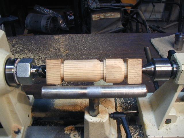

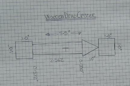

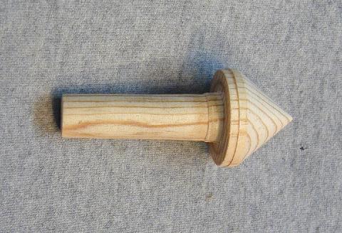

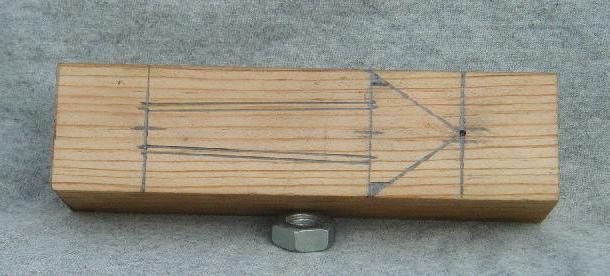

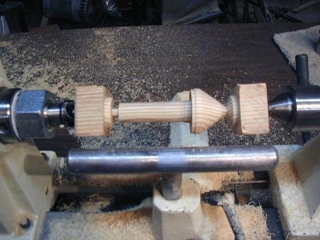

Just decided I was interested in the new technique of turning between centers that has been getting so much play recently. I didn't want to pay $7 shipping for a $3 item or wait a long time for the package when the PO is so slow at this time of year so I decided to make my own. Probably won't last forever; but it should do for one or two experiments so I can evaluate the process.
The Concept</u>
The Blank</u>
The Set-Up</u>
Turning Finished</u>
Ready To Use</u>
Actual work on the blank and turning time was about 15 minutes.

How well does it true up for driving. I tried softwood on a couple of things (key chuck and lathe chuck) and learned that softwood takes a delicate touch that is almost beyond me.
[B)]
I can see that you are wise enough to know that it would probably be good for one or two experiments only.

I was going to put a dial gauge on it to see how accurate it was; but didn't have time. It looks and feels very good. I suspect it is going to be more than accurate enough to do a good job turning.

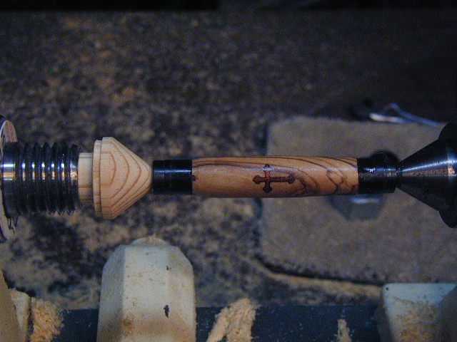

Mark: Here is the promised picture. Sadly, the quality is not great. I was fooling around with the spot meter and apparently messed up the exposure a little. I think you can see what you need to see; but if you want a better picture, I'll set-up for another one tomorrow.
