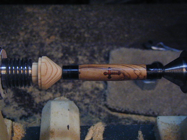

I haven't tried this out yet; but I think it should work well also. I tuned a sort of dead center out of a scrap of wood to fit in the HS MT pocket. Am going to try sanding and finishing with the blank between the wood dead center and the live center in the TS. With the taper of the two centers, it should be easy to keep the sandpaper clear of anything but the blank.
The second picture (not the best; but I was in a hurry) shows the setup in turning mode. For sanding and finishing, the bushings would be removed and the blank would be between the centers, only.
