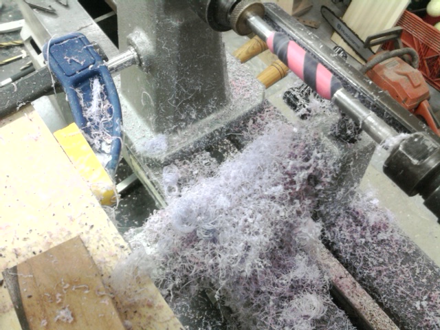

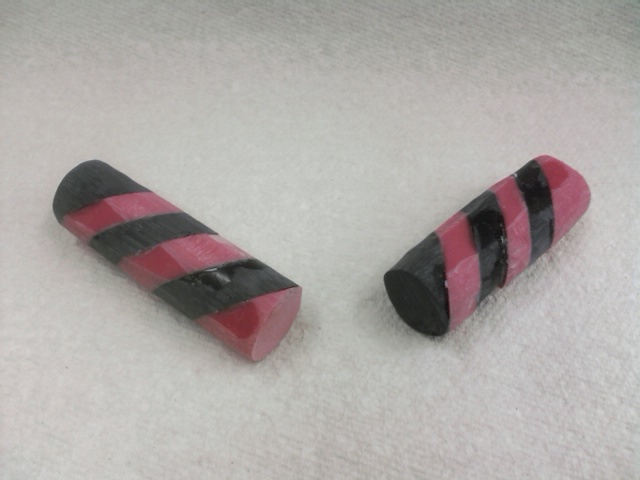

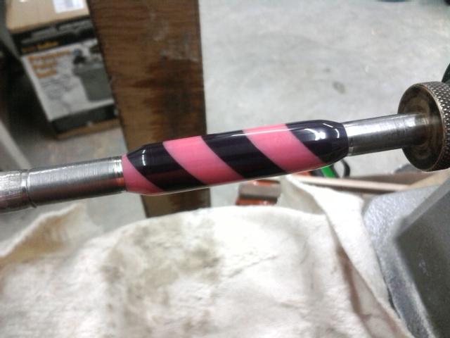

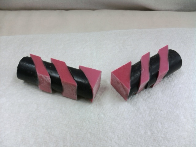

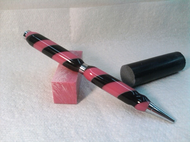

Here is one I just finished for a customer. She wanted a Purple and Pink slimline for a friend for Valentines day so I think this will fit the bill. The hard part was to fit together a round blank with a square blank. But, it turned out great. Here is a little bit of the process.

The blanks are Poly resin and cut at a 45 degree angle and lightly sanded and glued together with Med. CA. It's then wet sanded to 12000 and polished with plastic polish.
