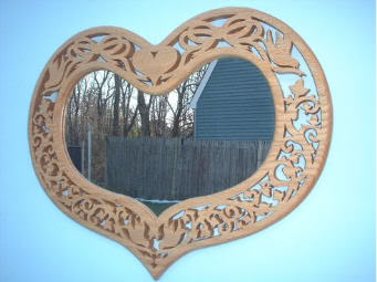

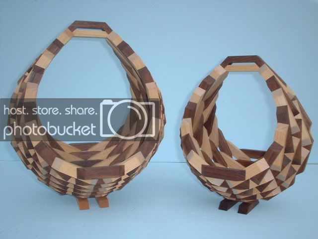

Here are some examples. Makes for a great finish.
The baskets are maple and walnut with a Danish oil. The mirror is red oak with danish oil and the guitar CD racks are finished with blo and topped with a waterbased lacquer.
