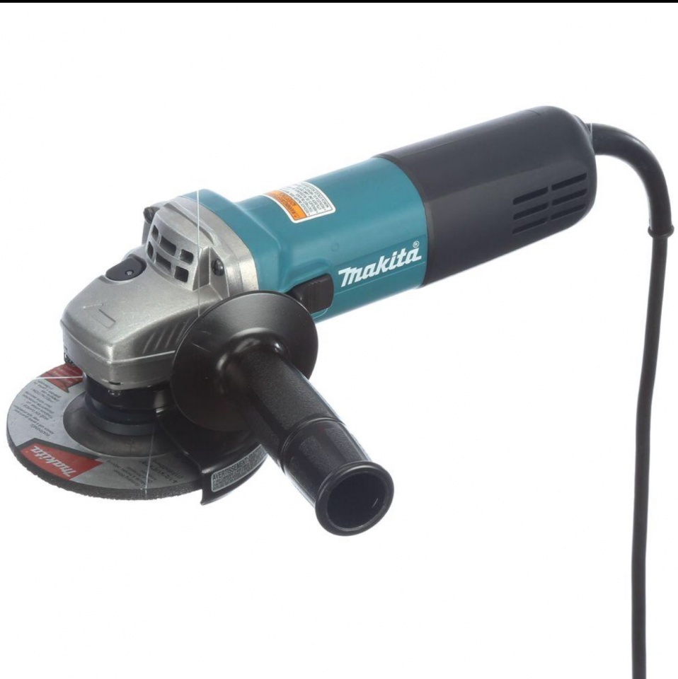

I don't think Dremel makes a heavy duty grinder. Mine is a 4.5" Dewalt 10,000 RPM. I've never seen one smaller than this. This is the tool weldors attach a 4.5" brush onto to clean slag off 5P and 6011 welds, especially on large pipe. There is nothing better for the purpose.

I am pretty sure Tom is talking about an angle grinder with a flap disc.
